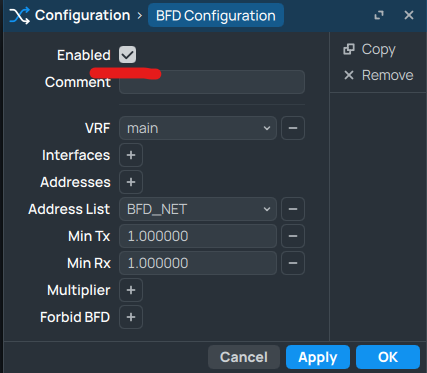

Does anyone know if there is an ongoing issue with BFD since 7.19.2?
Currently deploying a new 2116 on 7.19.4 and BFD for OSPF is not working.
Exact same model and config on 7.18.2, no issues.
Do you have BFD enebled for "directions" you want to have BFDed?
Please do not ask how much time it took me to find this obvious problem. Too much :slight_smile:
