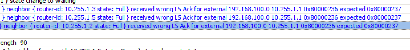

I am not sure if that’s something new or if it existed before.
When the router is restarted and OSPF starts sync with other routers, I always get those warnings:
After a while, those warnings disappear.
All routers run v7.2 and have almost identical OSPF config.
