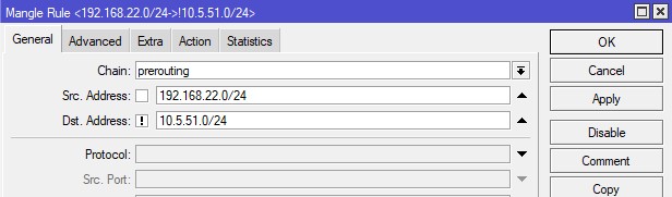

local VPN can’t see my local networks. my local VPN address is 192.168.22.0/32 and local network is 10.5.51.0/24. before upgrade to 7.2.3 everything working without any issue.
can you explain about this (“lookup in table *0x4000”), i have same problem, for me i have mangle rule, usually i override with route rule for some ip, for some reason it go to mangle rule route first and ignore the route rule, i decided to downgrade to 7.2.1 and all rule work again
for now I fixed this issue by mangle:
