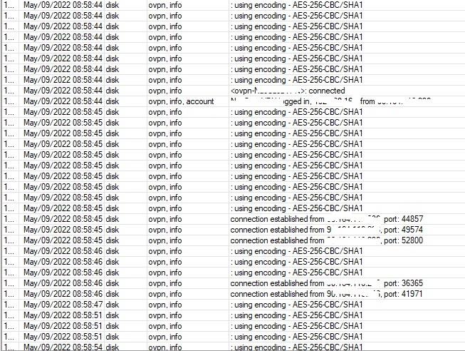

Hello!
RB3011 with 7.2.2
L2TP and SSTP stop working and we have to restart the router, this happens to us since 7.2.2
We have placed a script to restart the router every 24 hours, since we do not know what is happening.
We also have an OVPN with a NAS and the message log is filling me up, so many that it is impossible to see other messages easily
