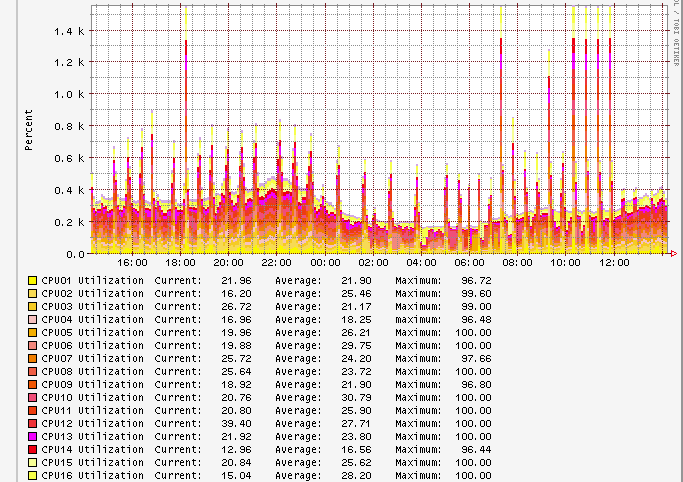

on CCR2216 with 3.2M routes (around 4 full routes) we had to disable the RPKI validation to avoid all cores go to 100% when validator update the cache.
we did it around 12.00pm and no more spike in cpu usage.
Now we deal with just one core running forever at 100% about routing:
tool/profile cpu=12
Columns: NAME, CPU, USAGE
NAME CPU USAGE
ethernet 12 2%
firewall 12 4%
networking 12 6.5%
management 12 0.5%
routing 12 81%
unclassified 12 2.5%
cpu12 96.5%

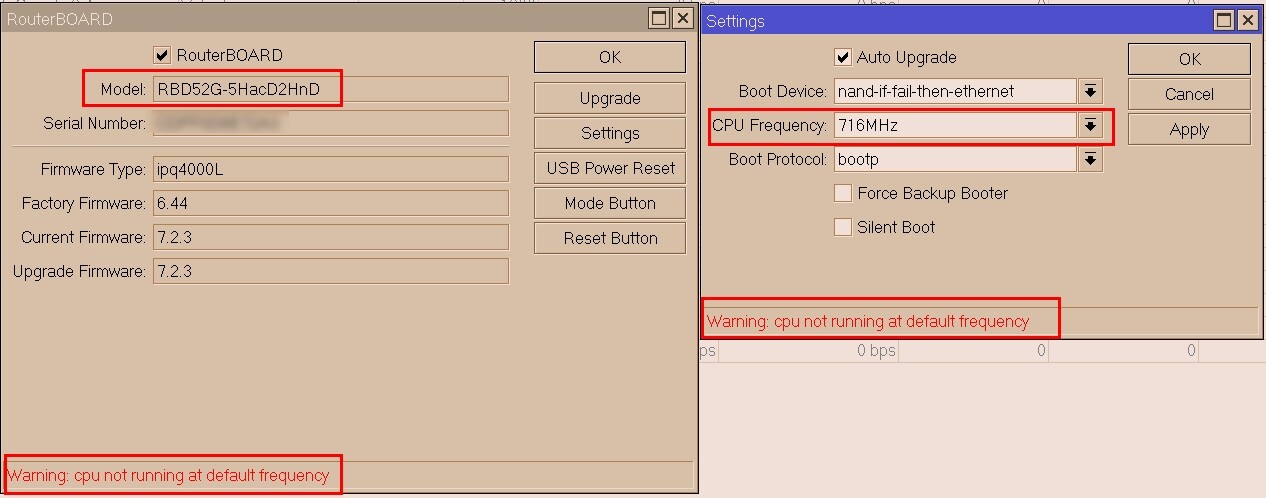

After upgrade to 7.2.3 getting “cpu not running on default frequency” on RBD52G-5HacD2HnD (hap ac2).
Bug?
A simple search before post something? “cpu not running on default frequency”?
http://forum.mikrotik.com/t/v7-2-is-released/157082/15
Yes, this is BUG… you must chose “auto” frequency.
This is not a bug, is wanted. New default is auto and if changed can be a problem.

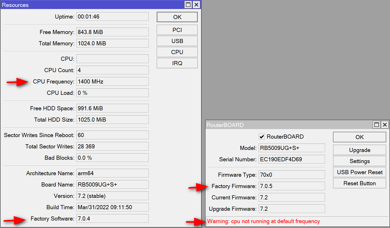

Default frequency is 716MHz. Not "auto" like 488MHz...So this is non logical bug about warning.
When is something default, it runs on frequency from factory.
Some users had to setup default frequency, because it want run full internet speed on "auto" frequency. (RB5009)
I have also Hap ac2 and I don't have this warning on 6.49.6.
Maybe try "auto" and then 716MHz..
Ok, if you do not have noticed that, this is a topic about routeros 7.2.2/3:
New default FOR ROUTEROS is auto, and if changed a warning is issued.
From device Specifications: CPU nominal frequency 350-1400 (auto) MHz
https://mikrotik.com/product/rb5009ug_s_in
Reading directly the Speec from
“Marvell® ARMADA® 7040 Quad-Core CA72 Processor with Marvell MoChi”
the default speed is… “up to 1.4 GHz

Why I mention this…I have also RB5009 with v7.
On v7 are two problems!
1.“cpu frequency warning” is gone in v6 on default frequency..in v7 still warning.
2. factory firmware is different in v7 on RB5009.
