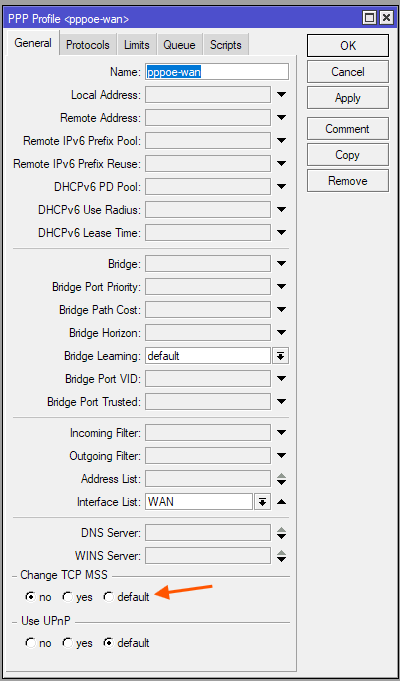

To workaround this, make a copy of the default PPP Profile. In this copy disable Change TCP MSS:
Then modify your PPPoE client interface to use this new PPP profile:
The MSS values of the TCP connection will no longer be clamped at 1452.

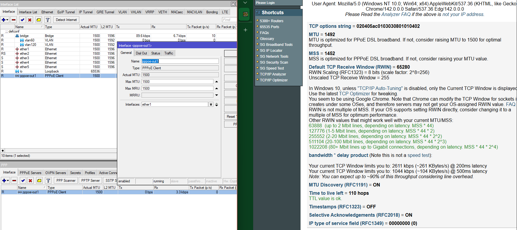

It will show MSS 1460 with the default profile if you keep the MTU of the underlying interfaces at 1508. Here are screenshots from the tests I just made on the spare RB750Gr3:
Don't forget that while doing the tests, you should either close/restart the web browser, or go to the IP -> Firewall -> Connections table and clear the connections before reloading the page (for the case where the old TCP connections from the previous test is still kept opened and is reused by the browser).
The tests show that when RouterOS adjusts the TCP MSS values of the PPPoE connections, it ignores the MTU value of the PPPoE client interface, and calculates the value from the MTU of the ethernet interface :expressionless:.

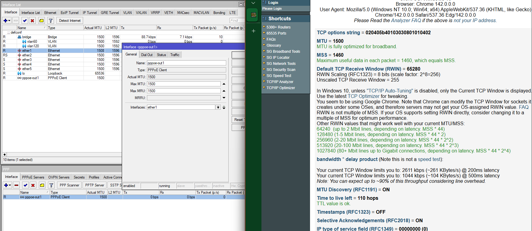

I followed your instructions and I think I’m there but my test results are slightly different:
TCP options string = 020405b4010303060101080a48efabb40000000004020000
MTU = 1500
MTU is fully optimized for broadband.
MSS = 1460
Maximum useful data in each packet = 1448, which is less than MSS because of Timestamps, or other TCP/IP options used.
Why is the actual data only 1448? I ran this in 2 different browsers on 2 different machines
It's in the text below the MSS value, but if you scroll down a bit on the speedguide.net result page, you'll see that it's due to Timestamps (RFC1323) = ON which adds 12 bytes to the TCP header of each packet.

Couple posts ago I had a “discussion” with @rextended about L2/L3 for PPPoE and the fact that I was able to obtain 1500 PPPoE MTU only by increasing L3 MTU of ethernet and VLAN to 1508.
Now I managed to connect remotely to a network and restored interfaces MTU to 1500 + PPPoE profile with TCP MSS = Off, now PPPoE MTU remains at 1500!
I'll do more tests, in the meantime great discover and thanks for the tip!
