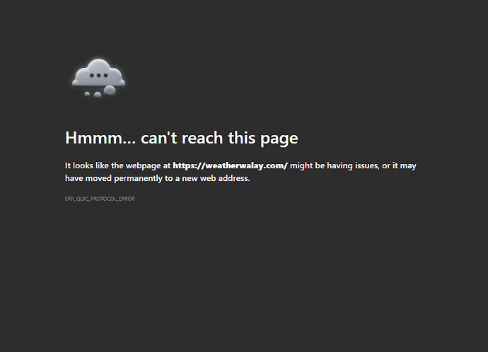

ERR_QUIC_PROTOCOL_ERROR with Cloudflare websites when using DOH on first few page loads, fine with plain DNS.
Is that an error displayed by the browser (as it is a Google protocol)? Anything in the logging on the MikroTik? Different behavior from previous version of RouterOS?

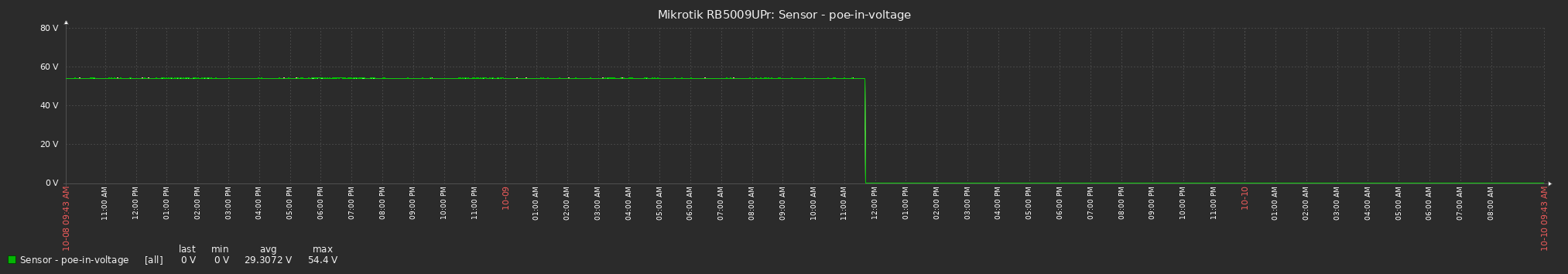

I'm running a RB5009UPr router with PoE, and I have been monitoring its input voltage. However, after the latest RouterOS update for version 7.20, I noticed that the PoE voltage is now reported as 0.
[RB5009] > system/health/print
#  NAME                 VALUE  TYPE
0  poe-out-consumption      0  W
1  cpu-temperature         49  C
2  jack-voltage             0  V
3  2pin-voltage             0  V
4  poe-in-voltage           0  V
Please, does anyone know what happened?
Please generate supout.rif file and send it to support@mikrotik.com

@erlinden i didn’t check it in previous versions, i further narrow it to: Using DoH on mikrotik and Chrome Browser and Cloudflare Websites.
Other sites work fine. Only on Chromium based browsers and on sites using cloudflare i get ERR_QUIC_PROTOCOL_ERROR Error Page.
Btw if i disable QUIC protocol in chrome then i get error connection reset.
