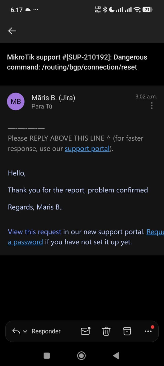

I was actually trying to reset the save-to parameter, which is only available via the CLI; I was NOT trying to reset the BGP session. Mikrotik has already confirmed the problem. Regards.
When you want to set a single parameter, you have to use the “set” command. “reset” does something else than you think it does.
Probably you will get a different response once the “confirmed problem” has been discussed internally.
Reset sets the parameters to default, so it's illogical that you can't then set a specific parameter to its default value using the CLI.
As far as I know reset works either on sections like*/settings or on whole entries (reset all parameters). To reset specific properties of an entry you either use unset value-name=<prop> or !<prop>. But I just saw it was already explained in detail by @CGGXANNX above.
