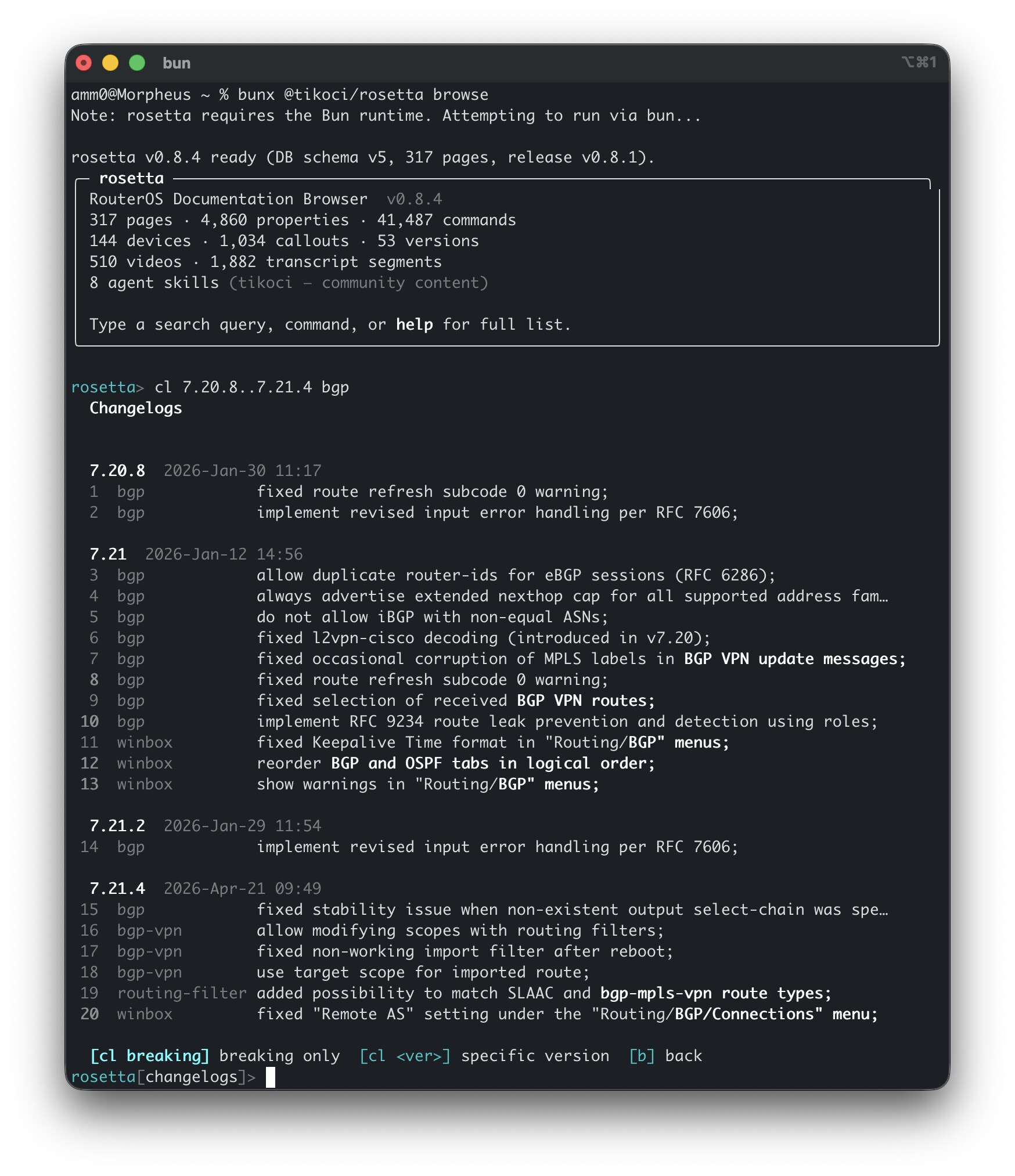

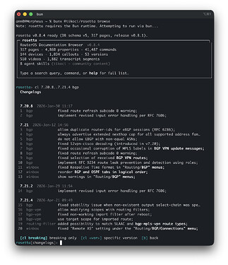

Well, my @tikoci/rosetta MCP server has a CLI/TUI for doing same queries as robots can against MikroTik docs/tests/changelogs/etc. See rosetta — tikoci.github.io for details. But you can do structured queries of the change log, so here is the TUI with a version range and topic "bgp"
You can also use CLI to grab it for cut-and-paste (pipx install term2md; :
bunx @tikoci/rosetta browse --once cl 7.20.8..7.21.4 | term2md | pbcopy
which get you the following (output is ANSI, so has to be converted to markdown for forum):
**Changelogs**
**7.20.8** 2026-Jan-30 11:17
  1  bgp            fixed route refresh subcode 0 warning;
  2  bgp            implement revised input error handling per RFC 7606;
  3  bridge         fixed dynamic switch-cpu VLAN creation (introduced in…
  4  container      fixed nftables/iptables not working with "Message too…
  5  health         fixed fan and PSU state logging for MIPSBE devices;
  6  poe-out        firmware update for 802.3bt capable boards (the updat…
  7  poe-out        fixed PSU state recovery upon unplug/replug on CRS320;
  8  ppp            added initial support for BG770A-GL modem firmware up…
  9  route          prevent creating routing tables with the same name;
**7.21** 2026-Jan-12 14:56
 10  arm64          allow enabling receive packet steering on /system/res…
 11  bgp            allow duplicate router-ids for eBGP sessions (RFC 628…
 12  bgp            always advertise extended nexthop cap for all support…
 13  bgp            do not allow iBGP with non-equal ASNs;
 14  bgp            fixed l2vpn-cisco decoding (introduced in v7.20);
 15  bgp            fixed occasional corruption of MPLS labels in BGP VPN…
 16  bgp            fixed route refresh subcode 0 warning;
 17  bgp            fixed selection of received BGP VPN routes;
 18  bgp            implement RFC 9234 route leak prevention and detectio…
**7.21.1** 2026-Jan-19 17:09
 19  bridge         fixed dynamic switch-cpu VLAN creation (introduced in…
 20  bridge         improved stability when using MVRP (introduced in v7.…
 21  certificate    fixed empty trust store handling in certain cases (in…
 22  container      changed app auto update to be off by default;
 23  container      fixed issue where containers may not start with large…
 24  health         fixed fan and PSU state logging for MIPSBE devices;
 25  leds           fixed power LED behavior for hAP ax S;
 26  lte            fixed APN configuration for QMI modems in a 3G networ…
**7.21.2** 2026-Jan-29 11:54
 27  app            added "media-path" and "download-path" setting in /ap…
 28  app            added shm_size parameter to apps that require it;
 29  app            calibre-web app auto add db if none exists;
 30  app            fixed Firefox and Webtop to work with https-proxy;
 31  app            fixed fossil app login typo;
 32  bgp            implement revised input error handling per RFC 7606;
 33  container      added support for the shm_size setting;
 34  container      allow non-root user write to SMB share;
**7.21.3** 2026-Feb-12 15:10
 35  bridge         fixed dhcp-snooping incorrectly disabling HW offloadi…
 36  certificate    fixed initial certificate creation using SCEP (introd…
 37  console        improved service stability when processing files over…
 38  dhcpv4-server  append "s" after lease-time value in setup command;
 39  gps            fixed port configuration for CubeG-5ac60ay;
 40  hotspot        rename totp-secret to otp-secret;
 41  ipv6           do not invalidate router if RA without included prefi…
 42  ipv6           fixed "on-link" and "autonomous" flag detection (intr…
**7.21.4** 2026-Apr-21 09:49
 43  bgp            fixed stability issue when non-existent output select…
 44  bgp-vpn        allow modifying scopes with routing filters;
 45  bgp-vpn        fixed non-working import filter after reboot;
 46  bgp-vpn        use target scope for imported route;
 47  bridge         fixed missing dynamic "switch-cpu" VLAN entry in WiFi…
 48  bridge         fixed performance regression in complex setups with v…
 49  console        removed the "reset" command from shared settings menu…
 50  container      fixed issue where the container might not start after…
[cl breaking] breaking only  [cl <ver>] specific version  [b] back
Now of course we do not actually know if all those changes made into 7.21.4, because the release process schemes are not documented anywhere...
But that's what I (or "rosetta") can tell you. Or you can let an AI assistant do the query for you which also has the docs to cross-ref, since the main use case for rosetta. But it was exactly these types of "changelog" (or "test results" which rosetta also collects) that built the non-AI "1980s library card catalog" TUI that does not require a LLM.
Also on web...
Use RouterOS Schema — Side-by-Side Diff webpage, select two versions (so 7.20.8 and 7.21.4 for long-term to long-erm), then open the "Show CHANGELOGs", which show the entire changelog history.
7.21.4 = 7.20.8 + bugfixes (mainly from 7.22 and 7.23). IMHO the version should have been 7.20.9.
