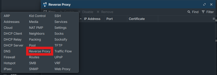

Wait where did this come from?
Well spotted, that can handle multiple things including caching SSL GSLB etc
i wonder if at some point Mikrotik will surprise us with a NGFW based on ROS Containers ^^
