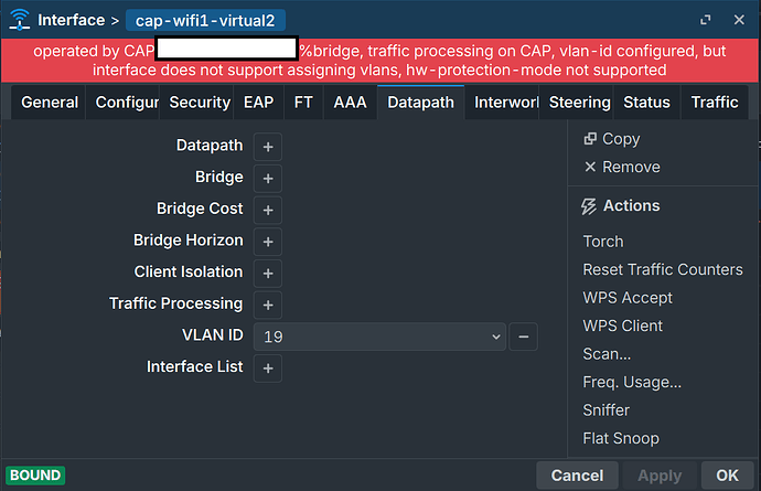

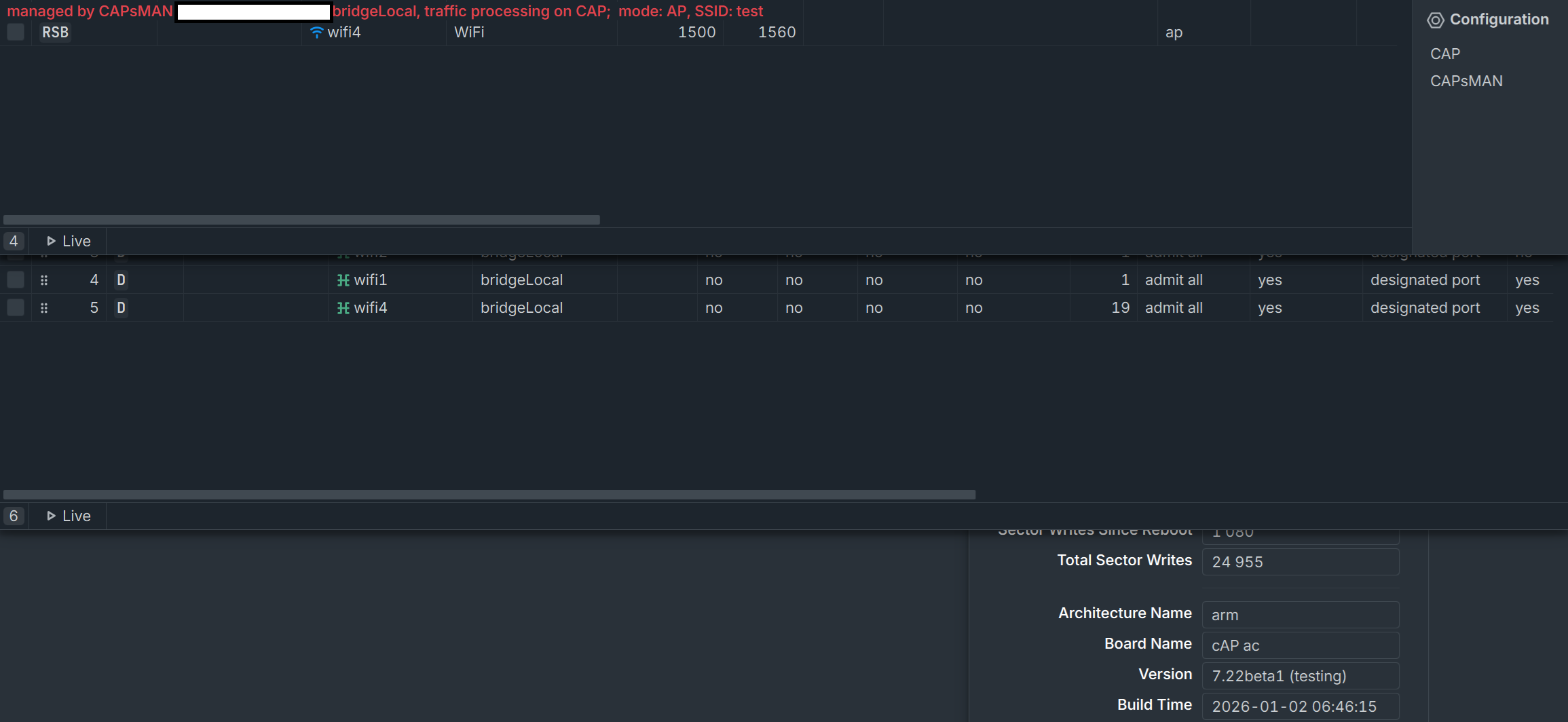

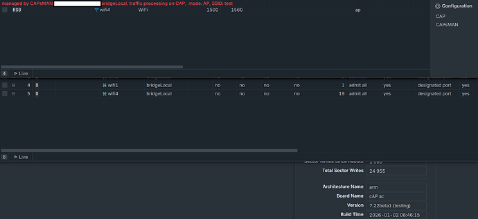

but that is not about drivers. that is about passing from CAPSMAN to CAP short message about PVID and dynamic appyling “add bridge=bridgeLocal interface=wifiX pvid=Y” on CAP. no drivers stuff here.
That’s not true, because this is already happening (dont believe me? Check for yourself)
But this interface also tries to dynamically assign VLAN to the client. ← Here’s the problem :slight_smile:
The driver doesnt support this.
This is NOT a capsman fix :slight_smile:

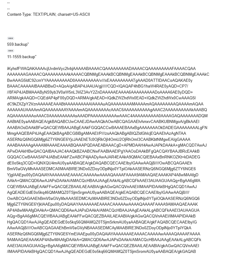

There is a issue with e-mail sending with attachment(file).
When attaching file is sending empty e-mail, or like in the picture:

Dude, Mikrotik wrote in manual:
“Check the dynamically created interface and assign the PVID to the appropriate one”
example in manual (so-called Mikrotik handjob):
add bridge=bridgeLocal interface=wifi1 pvid=10
add bridge=bridgeLocal interface=wifi21 pvid=20
add bridge=bridgeLocal interface=wifi2 pvid=10
add bridge=bridgeLocal interface=wifi22 pvid=20
Once again: CAP part can be easily fixed to read PVID of DYNAMICALLY created interface from CAPSMAN and accordingly execute DYNAMICALLY and AUTOMATICALLY:
and later accordingly execute remove or sth like that (opposition of “add”) if needed. No rocket science. Once again: current state of affair is an abomination of the very idea of CAPSMAN. Imagine that for some reason you have a huge network, like 20 APs, and now you a huge pleasure in so-called Mikrotik hand-job if for some reason to need to change VLAN ids. You need to login to each CAP and CHANGE PVIDs manually. That is not how CAPSMAN was supposed to work.

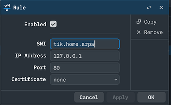

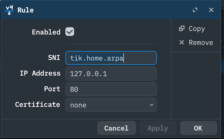

Yet another minor one in non-existent /ip/reverse-proxy, in "SNI Rules" it should allow a comment= field:
Note the lack of a "Comment" field

I think you got something mixed up here.
Dynamic entries dont show up on an export.
Next time please check for yourself first
19 is the VLAN ID
I do not mix anything. Please paste here export output from AC/XL AC.
then explain to me:
What does an export have to do with dynamic assignment?
P.s. Im not saying it currently works. IT DOESNT.
But im saying it does require work on wifi-qcom-ac NOT capsman :slight_smile:
And that is the problem. Thank you! CAP supposed to be dump device taking WHOLE configuration automatically from CAPSMAN. In case of CAPs AC/XL AC that is not case. We have to do mikrotik hand-job.
That is not about drivers, that is not about kernel-hardware interaction. That is about code in wifi-qcom-ac performing bunch of “add bridge=bridgeLocal interface=wifi22 pvid=20” and bunch of remove. That’s all.
i do agree on this part.
Its a little bit annoying to configure at the moment, but It's something i can live with for now :smiley:
(p.s. i did open a ticket about it recently)
