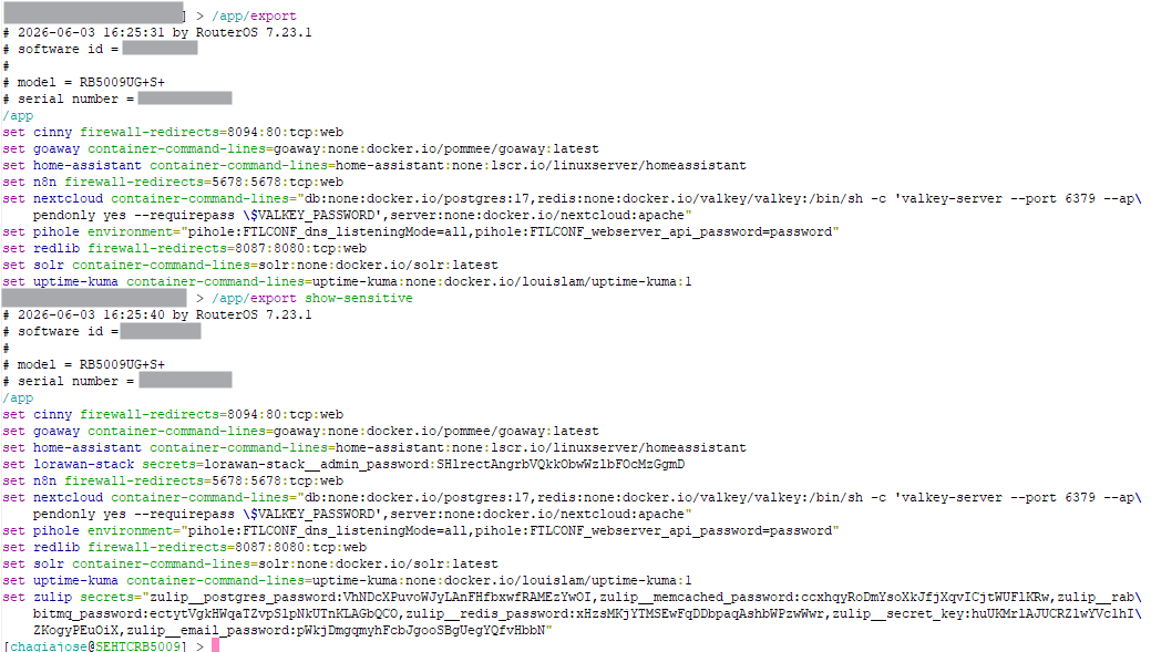

On my RB5009, /app export and /app export show-sensitive produce the following output:
The problem is that the RB5009 doesn't have any external storage attached, so /app settings disk cannot be configured (is none). As a result I cannot use the reset command to clear the setting:
The command fails because "need to configure disk to install apps to in /app settings". Which cannot be done because there is no disk available.

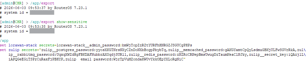

On a CHR installation with mounted disk partition, I can run the reset command for almost all apps, and /app export produces a clean output. However, /app export show-sensitive still shows two apps with secrets:
And there is no way to clear / reset / set to empty the secrets properties (failure: cannot change number of secrets).
To recap: Empty directories are no longer created. /app export still has bogus entries. Entries cannot be reset if device has no external disk. With external disk, most entries can be reset, except for two that have the secrets parameter that can never be empty, and will always show up with /export show-sensitive.

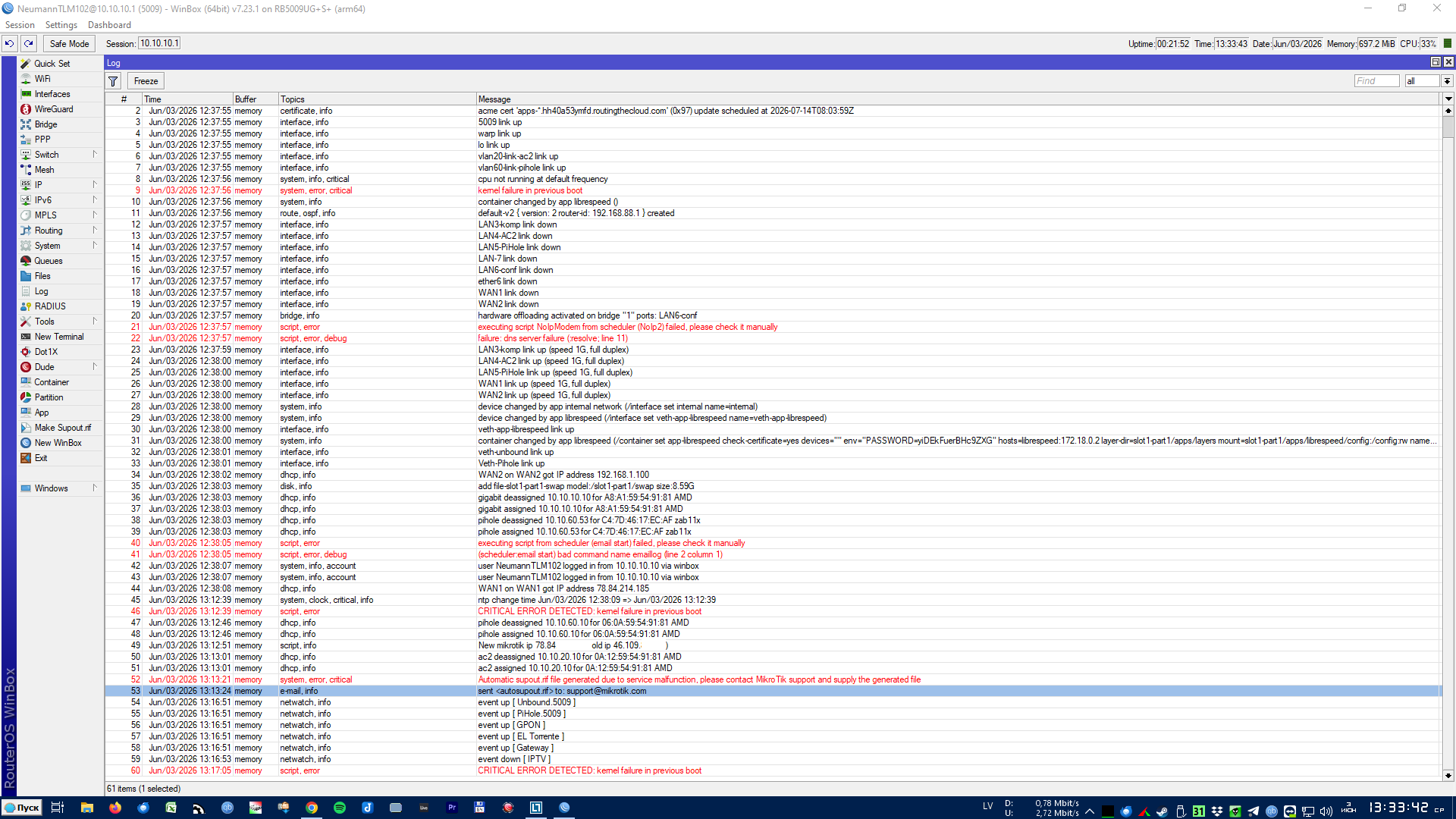

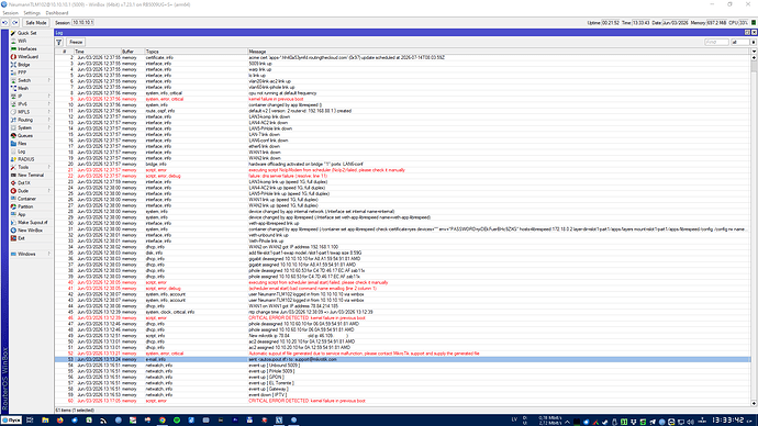

I updated and it said "system;error;critical" and "System rebooted because of ping watchdog timeout."
Then I did a manual restart. And then it crashed into a kernel panic.
