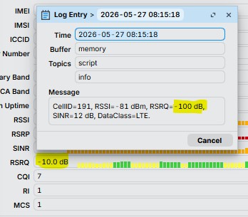

@rextended Thank you, your properly written script has very nearly fixed the issue. I assume that my old (terrible) script (which was pasted together from various parts of this forum) stopped working due to some change in behaviour. The good script you wrote almost works as expected...
Old script:
CellID=0, RSSI= dBm, RSRQ= dB, SINR=-80 dB, DataClass=.
@rextended script:
CellID=123, RSSI=-82 dBm, RSRQ=-110 dB, SINR=12 dB, DataClass=LTE.
There is now just one error with the output... the values that are decimals have their point stripped so -10.0 dB is reported as -100 dB. This happens at the...
:local RSRQ ($result->"rsrq")
... and not when the line is written to the log.
@rextended, do you have any suggestions? Thank you!
