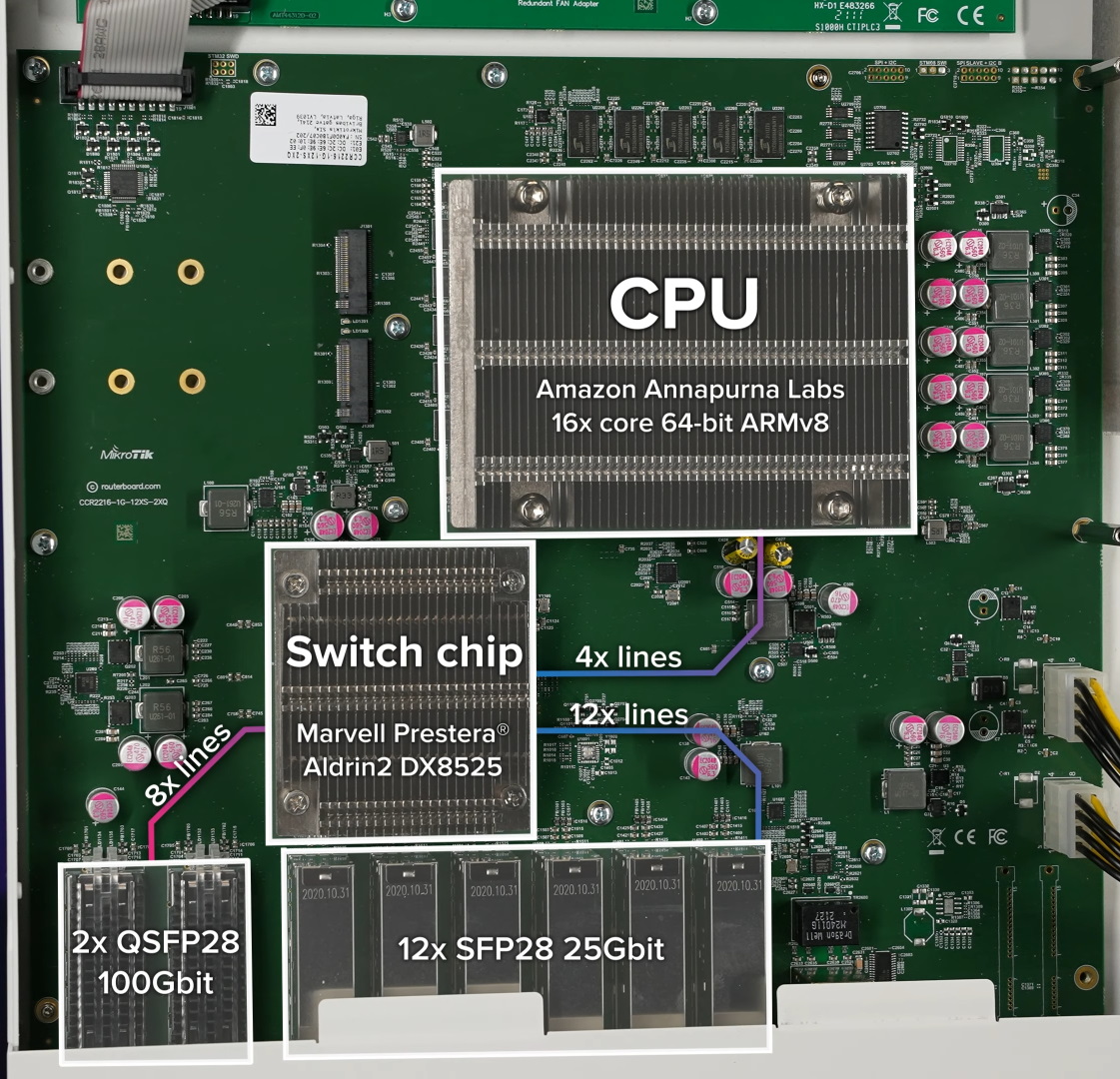

Also note that there’s no block diagram and no performance numbers at all for the CCR2216 :
https://mikrotik.com/product/ccr2216_1g_12xs_2xq#fndtn-specifications
Could you please add them ?
Many thanks !

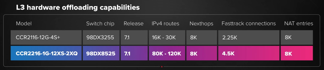

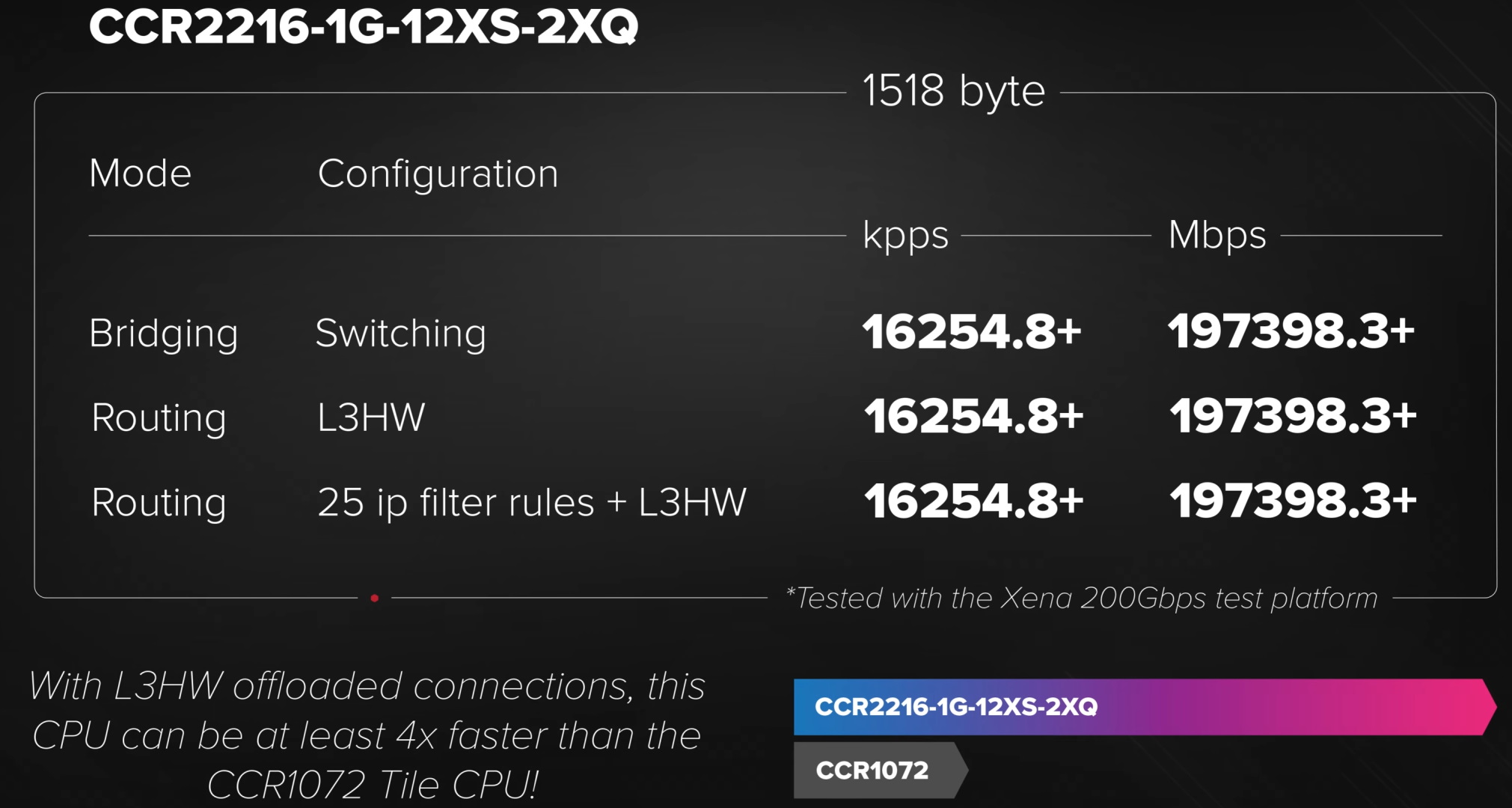

Here’s your MikroTik CCR2216-1G-12XS-2XQ Block Diagram, each line is 25Gbps.
And performance numbers:
And L3HW capabilities:
Many thanks @Znevna for the CCR2216 details.
Would also be nice to have some numbers without l3hw, so that we would know what to expect from this device once hardware table is full (or if l3hw is intentionally disabled).
Same for CCR2116 of course.
@MikroTik support ? :slight_smile:
And for CCR2116 ipsec numbers, I think we’ll need @MikroTik support, to have their test procedure applied, to get a proper comparison to other models.
Thank you again !
