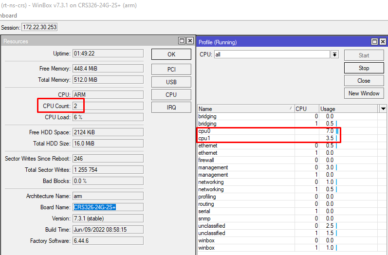

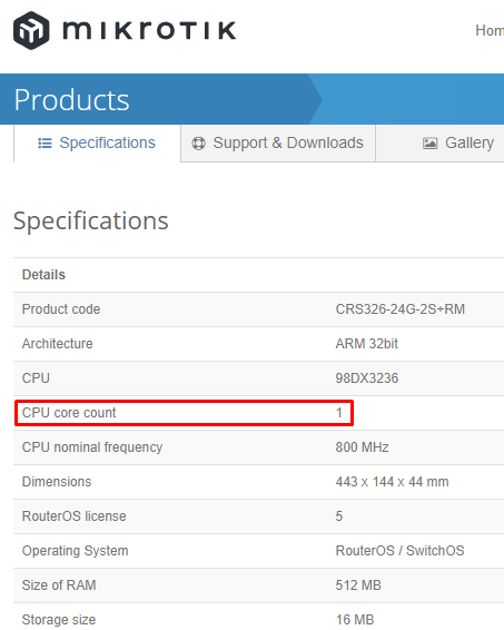

Today I updated my CRS326-24G-2S+ to 7.3.1. Something wrong?
Info from site:
Info from WinBox:

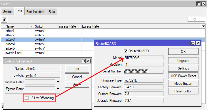

I used the instructions L3 Hardware Offloading for my CRS326-24G-2S+. ROS 7.3.1
After saving the configuration data in text form (/export compact terse show-sensitive file=xxx) , there is no information in the file about l3hw on all switch ports.
Only data about switch:
/interface ethernet switch set 0 l3-hw-offloading=yes
That means that for the global setting the default is “no” and for the per-port settings the default is “yes”.
The output you are looking for is probably in output of
/interface/ethernet/switch/port export verbose
It is like ‘show run all | sec interface’ in Cisco world.
