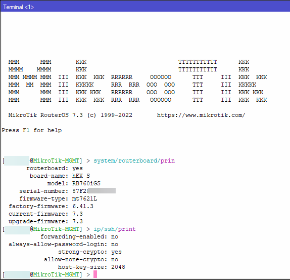

hEX S upgraded from 7.2.1 to 7.3 and now /ip/ssh> print throwing out: error - contact MikroTik support and send a supout file (2)
Same when exporting config: #error exporting /ip/ssh
Initially set:
strong-crypto: yes
host-key-size: 4096
Even when reverting to strong-cryto: no and host-key-size: 2048 (default values) - same thing.
On 7.2.1 all smooth.
Have another RB4011 running on 7.3 without any issues and all fine with /ip/ssh settings - so it seems to be a phenomenon on hEX S only.
Zerotier no longer gets an IP address?
twamuc - Could you please provide supout file to support@mikrotik.com? Generate a file after you have noticed such an error while running v7.3.
Strange Works fine on my hex S.

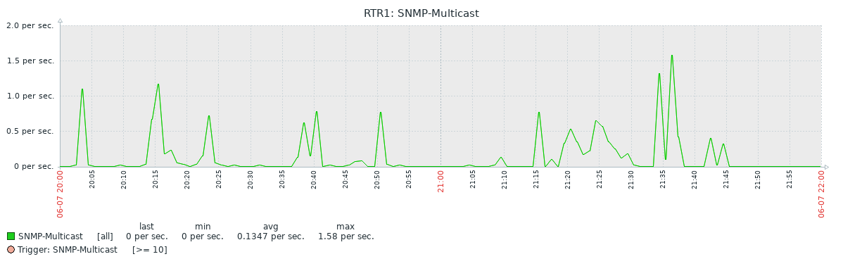

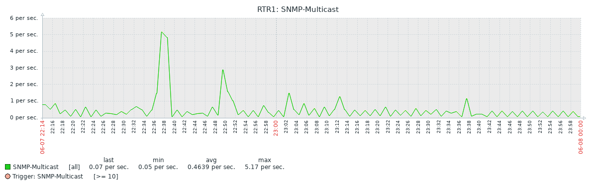

@MT, have you worked on the PIM-Routing? I see nothing in the cangelog.
In a random Wireshark-Scan, I see the IGMP-Querier is working (from the ROS7.3 device) and sending IGMP Membership Queries.
This happended also with <=ROSv7.2.x but after a few minutes it totally hang up…
Have not tested yet if the actual Multicast-Routing is working too.
ROSv7.2.3 (IGMP Querier not working, a few spikes but no continuous frames):
ROSv7.3 (continuous IGMP-Frames (the wwwww at the bottom of the graph), which - I suspect - are the Queries from the Querier):
