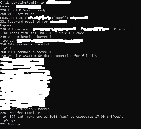

Please paste exactly what a commandline ftp client shows when you logon to that server.

Proftpd 1.3.7a

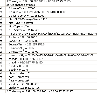

well, dear MT staff
/ip dhcp-server vendor-class-id add address-pool=Lan-200-UEFI name=UEFI-200 server=Lan-200 vid=PXEClient:Arch:00007:UNDI:003016
/ip dhcp-server vendor-class-id add address-pool=Lan-1000-UEFI name=UEFI-1000 server=Lan-1000 vid=PXEClient:Arch:00007:UNDI:003016
/ip dhcp-server vendor-class-id add address-pool=Lan-1000-UEFI name=UEFI-1000-VBOX server=Lan-1000 vid=PXEClient:Arch:00007:UNDI:003000
/ip dhcp-server vendor-class-id add address-pool=Lan-200-UEFI name=UEFI-200-VBOX server=Lan-200 vid=PXEClient:Arch:00007:UNDI:003000
/ip dhcp-server vendor-class-id add address-pool=block name=Andr11 server=Lan-200 vid=android-dhcp-11
/ip dhcp-server vendor-class-id add address-pool=block name=Andr10 server=Lan-200 vid=android-dhcp-10
/ip dhcp-server vendor-class-id add address-pool=block name=Andr9 server=Lan-200 vid=android-dhcp-9
/ip dhcp-server vendor-class-id add address-pool=block name=Andr12 server=Lan-200 vid=android-dhcp-12
/ip dhcp-server vendor-class-id add address-pool=block name=HUAWEI:android:MRD-L21A server=Lan-200 vid=HUAWEI:android:MRD-L21A
/ip dhcp-server vendor-class-id add address-pool=block name=HUAWEI:android:CLT server=Lan-200 vid=HUAWEI:android:CLT
/ip dhcp-server vendor-class-id add address-pool=block name=dhcpcd-5.5.6 server=Lan-200 vid=dhcpcd-5.5.6
this does NOT work any more
why change something which worked before ???
how to match UEFI from now ?
as MT DEVs could see
UEFI client asked for IP and totally wrong answer came from MKT
lpxelinux.0 instead of grubnetx64.efi.signed
clearly, Class-Id = “PXEClient:Arch:00007:UNDI:003000” does not match in DHCP server

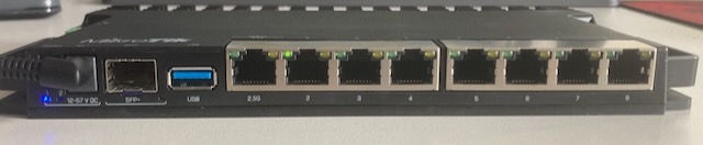

Yes, I have. But what I’ve observed in the past, is that the RB5009 (or RB4011, my previous) would show certain activity via the LEDs when powered on, and getting into Netboot via the RESET button, the activity changes.
My RB5009 simply powers on, shows the Blue LED, and the Eth2 LED (faintly), and nothing changes. This is whether powered on “normally”, powered on with RESET held, or holding RESET immediately after power on.
I believe I’ve seen posts online saying that the faint LED on Eth2 is more than likely an indicator of a hardware failure.
if it looks like that, it’s probably dead. I had to rma my RB5009, just 4 days after I got it. Died during fw update.
@osc86 how about trying to netinstall the device ?

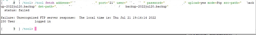

When that " The local time is" line indeed has a CR/LF in front of it, this certainlu is a fault of the FTP server!
There should be “230-” in front of that line, just like the “230-Welcome user” line.
So try to find why it outputs that line and how it can be removed or corrected.
Why did it not fail in previous RouterOS? Likely, someone reported that the FTP client did not handle errors properly,
e.g. when the user/password was refused it would not notice that, and now the FTP client does proper parsing of those
3-digit numbers on each line (which are error/status codes). It now fails because your FTP server sends garbage.

@Zacharias netinstall didn’t work. RMA center confirmed that the device is broken.
That’s exactly what mine looks like.
I don’t think that’s right:
Ok I apparently assumed to easily that the line format for FTP would be the same as for SMTP, where certainly it is as I described.
I seem to remember that FTP servers sending large banners always formatted them with those continuation reply codes in front of every line, but maybe that was just the safest thing to do.
At the moment, it is difficult to confirm that as FTP has been phased out by most sites by now.
Edit: this is what I meant:
Connected to ftp.nluug.nl.
220-Welcome to the FTP archive of
220-The Netherlands Unix Users Group (NLUUG).
220-
220-This server is located in The Netherlands, Europe.
220-If you are abroad, please find an ftp site near you.
220-Most information on this site is mirrored.
220-
220-Information about your login and any transfers you do are logged.
220-If you don't like this, disconnect now.
220-
220-For statistics, see http://ftp.nluug.nl/.statistics/
220-Problems?  Mail ftp-admin @ nluug.nl
220-
220-You may login as "ftp" or "anonymous".
220-
220
But then indeed it appears that the changes in v7.4 do not conform to the RFC959 standard and need more work to handle the format as described in the RFC.
Well, well…
For obscurus: note that likely nothing further will happen unless you make a ticket about this (either by mailing it or by directly creating the ticket in the support system). Bugs reported in the release topics are usually not picked up by MikroTik staff, unless a developer of a particular piece of code sees it and creates the ticket himself.
