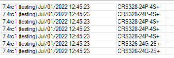

Successfully installed on following devices (ROS and FW):
Until now no problems :slight_smile:
