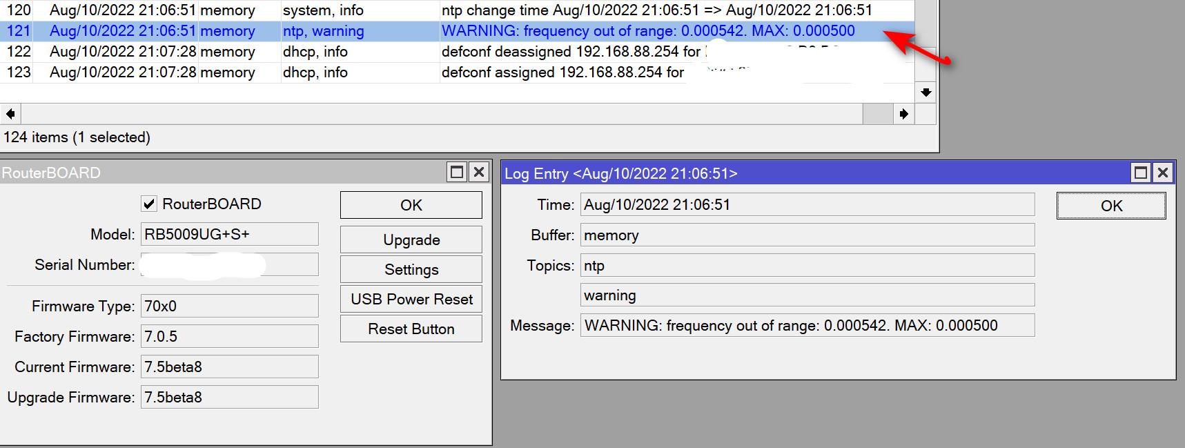

I have problem with ntp for now. When I setup some ntp servers to stratum 1 it shows: WARNING: frequency out of range: 0.000542. MAX: 0.000500
Is it normal?
Considering it appeared right after a time sync, you figure it out.
