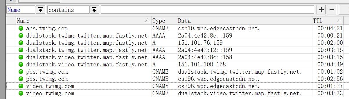

I think I may have found a reason why DNS forward-to can be incorrect.
As seen in the picture, video.twimg.com has two CNAMEs, which is definitely not correct. We can use the example of “video.twimg.com CNAME dualstack.video.twitter.map.fastly.net TTL=00:03:33” to illustrate the problem that can occur with DNS forward-to.
From these two pieces of data, we can see that “dualstack.video.twitter.map.fastly.net A 151.101.76.159” will expire first. So if “dualstack.video.twitter.map.fastly.net A” expires and the client requests a resolution for “video.twimg.com”, the DNS resolver will find the CNAME and attempt to resolve “dualstack.video.twitter.map.fastly.net”.
However, the code rule we set is “forward-to=1.1.1.1 regex=(.|^)(twitter|twimg).com$”, which can only match “video.twimg.com” but not “dualstack.video.twitter.map.fastly.net”. Some may argue that this setting is correct, but if the DNS cache is cleared, then “video.twimg.com” and subsequent CNAME resolutions will use “forward-to 1.1.1.1”, creating a logical conflict.
Therefore, I think we should add a tag to the result of “video.twimg.com CNAME dualstack.video.twitter.map.fastly.net” resolution to mark “dualstack.video.twitter.map.fastly.net” as “forward-to 1.1.1.1”. This will ensure that when we resolve “dualstack.video.twitter.map.fastly.net” in the future, the result will be consistent with clearing the cache.
This is a problem that we often encounter where the DNS resolution works fine at the beginning, but eventually causes streaming problems.

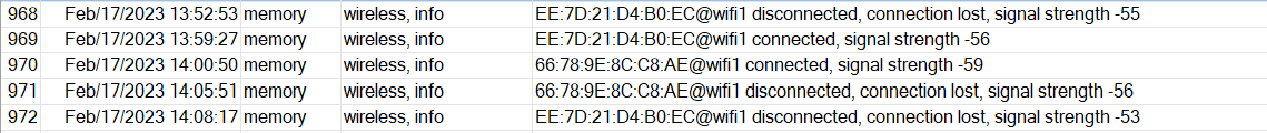

All 6 iPads Air with iPadOS 16.3.1 we have now keep disconnecting and reconnecting as soon as the screen turns off.
They are with the screen off and above the table, once the display is switched on, they remain connected.

I can’t understand why with 7.8rc2 iPads have this problem.
What version did these last work in?
hAP ax3 with 7.6 and 7.7, used for two weeks, never noticed.
Unfortunately I can’t downgrade…

Nothing, same thing… after 5/10 minutes that the screen is off, the disconnections begin.
They do it even if I use only one wireless interface (2.4 or 5 GHz).

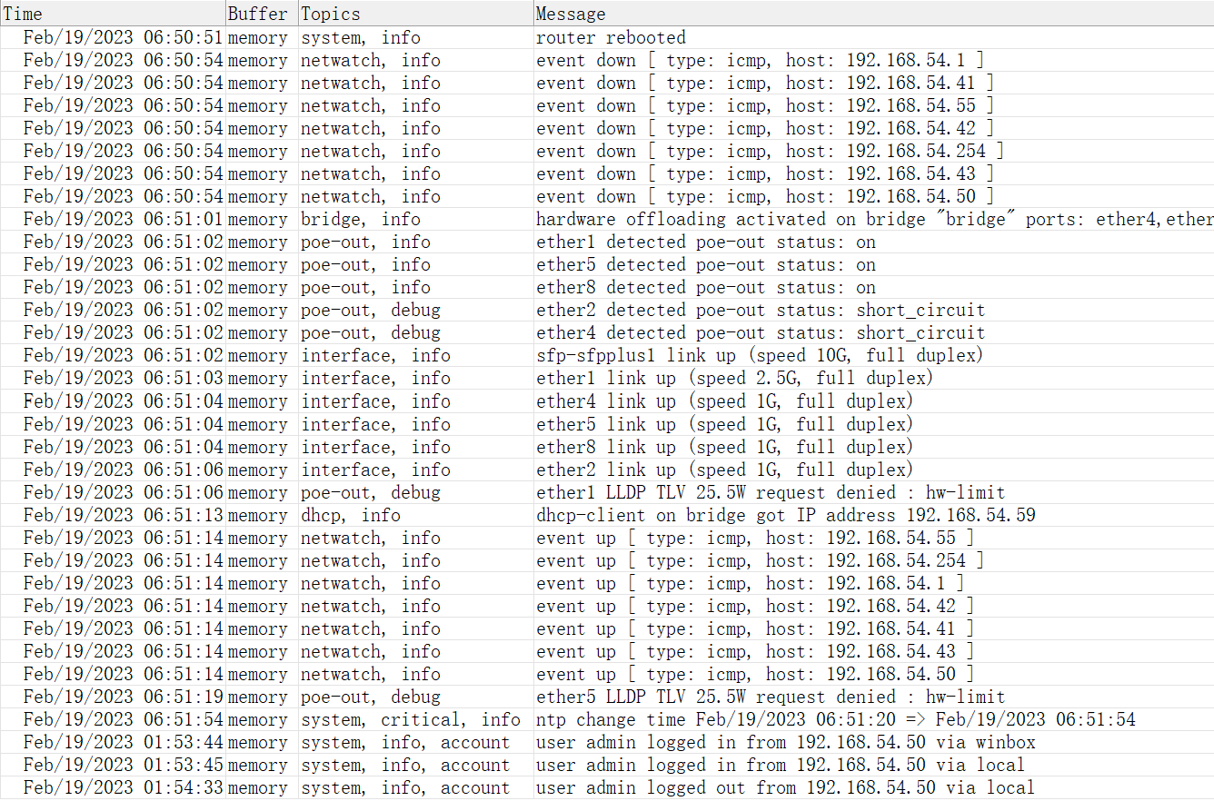

I have a RB5009UPr+S+IN with an SFP+ module that sometimes fails to start, and experiences 2.5G port flapping.
After upgrading to 7.8rc2, not only does port flapping still occur, but there are also negotiation issues where the port changes from 2.5G to 1G and then to 100M.
The only solution I have found is to reboot the device, which temporarily restores the 2.5G connection until the flapping starts again.
here is the image after reboot. the ether1 will back to 2.5Gbps. just reboot.

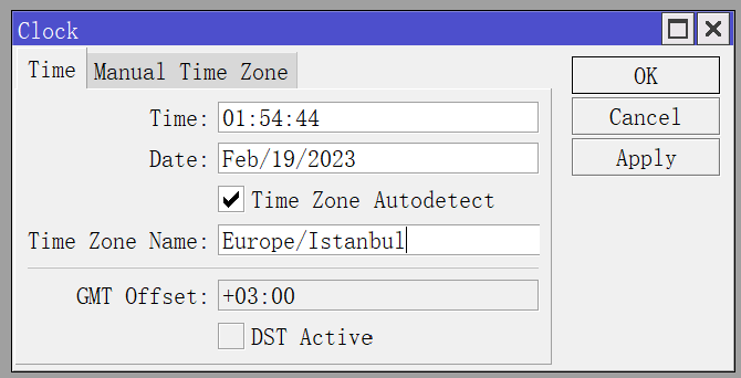

Then I found another problem after the reboot: every time I reboot, my clock is changed to Europe/Istanbul. It’s so strange, no matter how I change it, it always changes back to Europe/Istanbul after reboot. I didn’t pay attention to this issue before.
