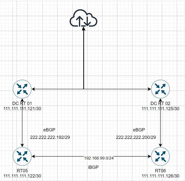

I’m trying to setup a multi-home situation with two mikrotik routers that are v7. Each router has a port to our ISPs router and they have two ports and two routers each with BGP session running. Each router on our side has a cross-connect over on 192.168.99.0/24. I have iBGP sessions running on 192.168.99.0/24 sending RT05 the network of 222.222.222.200/29. I want RT05 to advertise that to DC RT 01 with the path prepending so it’s a backup route if the physical connection drops between RT06->DC RT 01. I can see 222.222.222.200/29 in the route table for RT05, I setup a Router Filter of the below to prepend the path so the upstream routers only use it for a backup and set it on the connection output filter. Our provider lets us advertise our /29 to them via bgp.

Both 222.222.222.200/29 and 222.222.222.192/29 are in an address list the BGP connection is pointing to. Both are in the route table as well.

My ISP had our /29 prefix set to on router each so announcing it was getting blocked from their own prefix filters. I asked, which I’m glad I did, and they updated their config on their cisco routers and a quick ping test showed I can swap primary routes just fine on the two connections.
