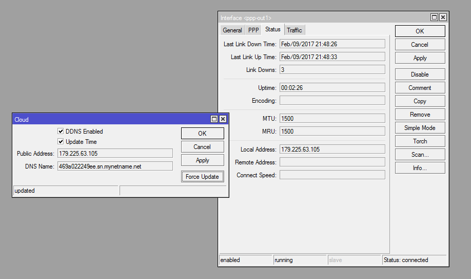

Good evening, ladies, I’m having problems with ip valid, because the operators are with few available ips and pass ips starting at 100.0.0.0 and thus the MK Cloud does not update with the correct IP and I lose access to an IP camera that is running Behind a RB with ppp to the USB of the 3g Modem from VIVO, does anyone have any suggestions for the problem in question
Isso é CGNAT migra pro IPv6

Infelizmente não tem suporte a IPV6, além disso preciso acessar uma câmera IP que está atrás dessa RB com IP Válido.

Besides IPv6, you can try to use a script that reboot the interface ppp-out to renew IPv4 when is 100.0.0.0/8 and get a valid IP instead of CGNAT.
I find Script.
{[:local pppIP [/ip address get [find interface=ppp-out1] address]; :if ( [:pick $pppIP 0 [:find $pppIP . ]] = 100 ) do={/interface pppoe disconnect ppp-out1 ; :delay 5s ; /interface pppoe connect ppp-out1}]}

In some places the providers are giving only the CGNAT addresses, you can try to change operator.
I use TIM and got valid IPV4 address, and IPv6 (São Paulo).
Another solution which I use to keep access and to be away from port blocking is to create a VPN from the router to a place where you have an valid IP address and create a port redirect from this valid IPV4 place to the router behind NAT.
