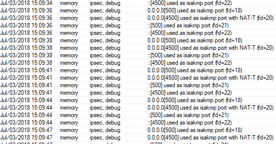

I’m facing a weird problem, with both 6.42 and 6.43rc on my Hap ac2.
Whenever I choose anything else than sha1 for my ipsec peer proposal, the ipsec client just keeps “crashing” and packets never reach the server
Another problem, when switching to sha1, the router never acknowledges the IKE2 response.
It will send 2 retransmits, then timeout and restart. The server (strongswan) sees the retransmits and reply every time.
I can see the packets coming on 4500/udp using the packet sniffer, and the firewall rules match, but for some reason they are ignored.
Any ideas?

Seems like something is wrong here… I’ll contact support

Before contacting support, upgrade the firmware and try again..
Upgrading the firmware did not help.
