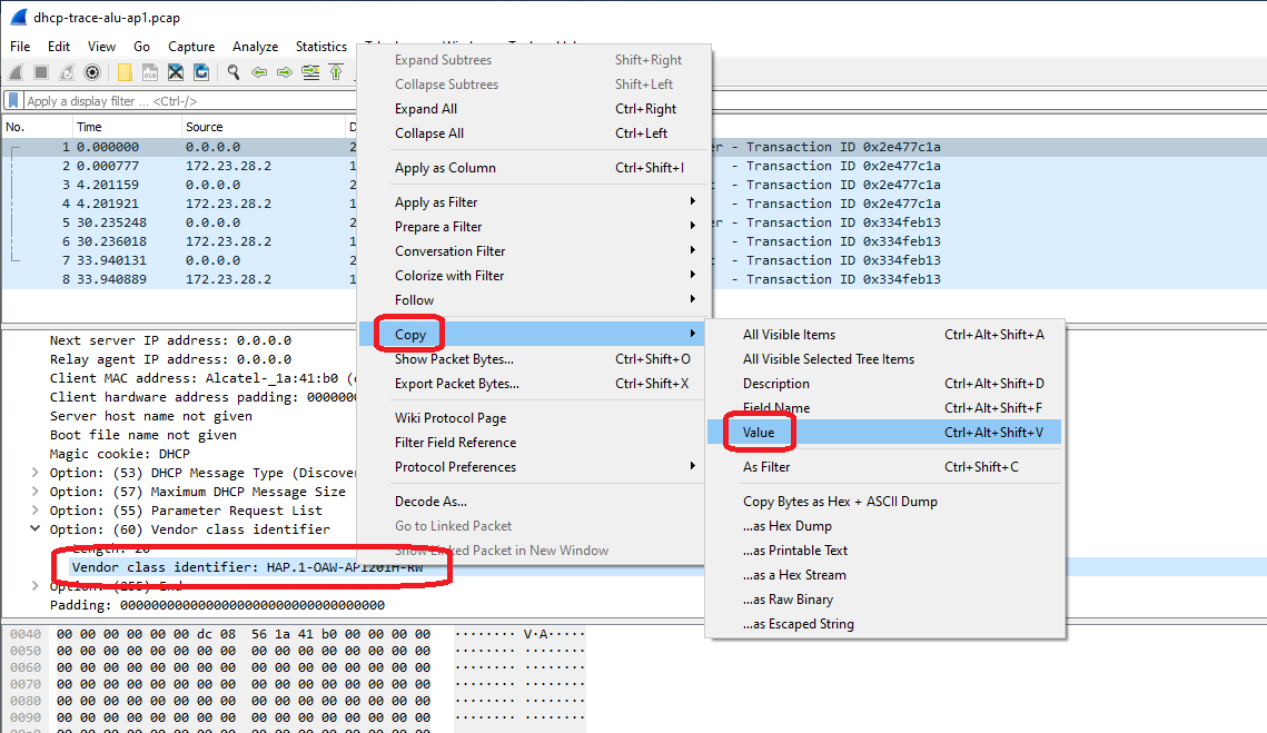

maybe santa puts “wireshark” under your tree ?!
… you copied the hex-code with delimiters from the log-dump into your data-field … not very convincing ( if I were a computer and had a saying in here )
collect your dhcp-packets with → Tools → Packet sniffer
read out your vendor-spec data with wireshark
build your vendor-class-identifier and a vendor-spec pool … end of thing ( … pour yourself an eggnog : )

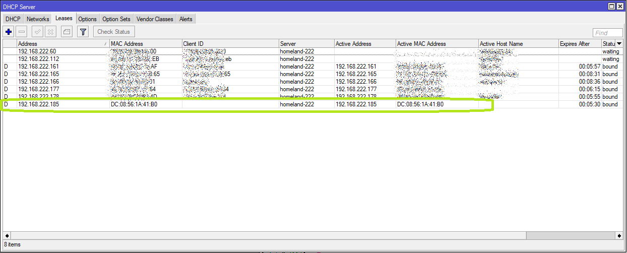

[admin@tikki] >
19:33:42 echo: dhcp,debug,packet homeland-222 received discover with id 251080787 from 0.0.0.0
19:33:42 echo: dhcp,debug,packet     ciaddr = 0.0.0.0
19:33:42 echo: dhcp,debug,packet     chaddr = DC:08:56:1A:41:B0
19:33:42 echo: dhcp,debug,packet     Msg-Type = discover
19:33:42 echo: dhcp,debug,packet     Max-DHCP-Message-Size = 576
19:33:42 echo: dhcp,debug,packet     Parameter-List = Subnet-Mask,Router,Domain-Server,Host-Name,Domain-Name,Broadcas
t-Address,NTP-Server,Vendor-Specific,Unknown(66),Unknown(67),CAPWAP-Server
19:33:42 echo: dhcp,debug,packet     Class-Id = "HAP.1-OAW-AP1201H-RW"
[admin@tikki] >
  (1 messages discarded)
19:33:42 echo: dhcp,debug,packet     yiaddr = 192.168.222.185
19:33:42 echo: dhcp,debug,packet     siaddr = 172.23.28.2
19:33:42 echo: dhcp,debug,packet     Msg-Type = offer
19:33:42 echo: dhcp,debug,packet     Server-Id = 172.23.28.2
19:33:42 echo: dhcp,debug,packet     Address-Time = 600
19:33:42 echo: dhcp,debug,packet     Subnet-Mask = 255.255.255.0
19:33:42 echo: dhcp,debug,packet     Router = 192.168.222.254
19:33:42 echo: dhcp,debug,packet     Domain-Server = 192.168.222.42
19:33:42 echo: dhcp,debug,packet     NTP-Server = 192.168.222.25
19:33:42 echo: dhcp,debug,packet     CAPWAP-Server = 192.168.222.25
[admin@tikki] >
  (11 messages discarded)
19:33:46 echo: dhcp,debug,packet     ciaddr = 0.0.0.0
19:33:46 echo: dhcp,debug,packet     yiaddr = 192.168.222.185
19:33:46 echo: dhcp,debug,packet     siaddr = 172.23.28.2
19:33:46 echo: dhcp,debug,packet     chaddr = DC:08:56:1A:41:B0
19:33:46 echo: dhcp,debug,packet     Msg-Type = ack
19:33:46 echo: dhcp,debug,packet     Server-Id = 172.23.28.2
19:33:46 echo: dhcp,debug,packet     Address-Time = 600
19:33:46 echo: dhcp,debug,packet     Subnet-Mask = 255.255.255.0
19:33:46 echo: dhcp,debug,packet     Router = 192.168.222.254
19:33:46 echo: dhcp,debug,packet     Domain-Server = 192.168.222.42
19:33:46 echo: dhcp,debug,packet     NTP-Server = 192.168.222.25
19:33:46 echo: dhcp,debug,packet     CAPWAP-Server = 192.168.222.25
[admin@tikki] >
