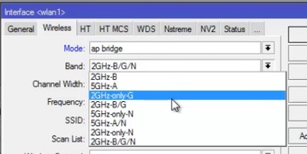

OK; the block diagram shows only one radio. So either you operate in 2.4GHz or in 5 GHz. But both are possible and depend on your configuration setting.
So I expect that you see something like this list in the config options for wireless WLAN1. The list contains 2.4GHz and 5 GHz bands.
(taken from https://www.youtube.com/watch?v=R4jOSp7sKVA , just to have the image)
So the selection of a 2.4GHz unit and a 5 GHz unit is yours. Or not. Sorry please explain, can’t follow what your request really is.
