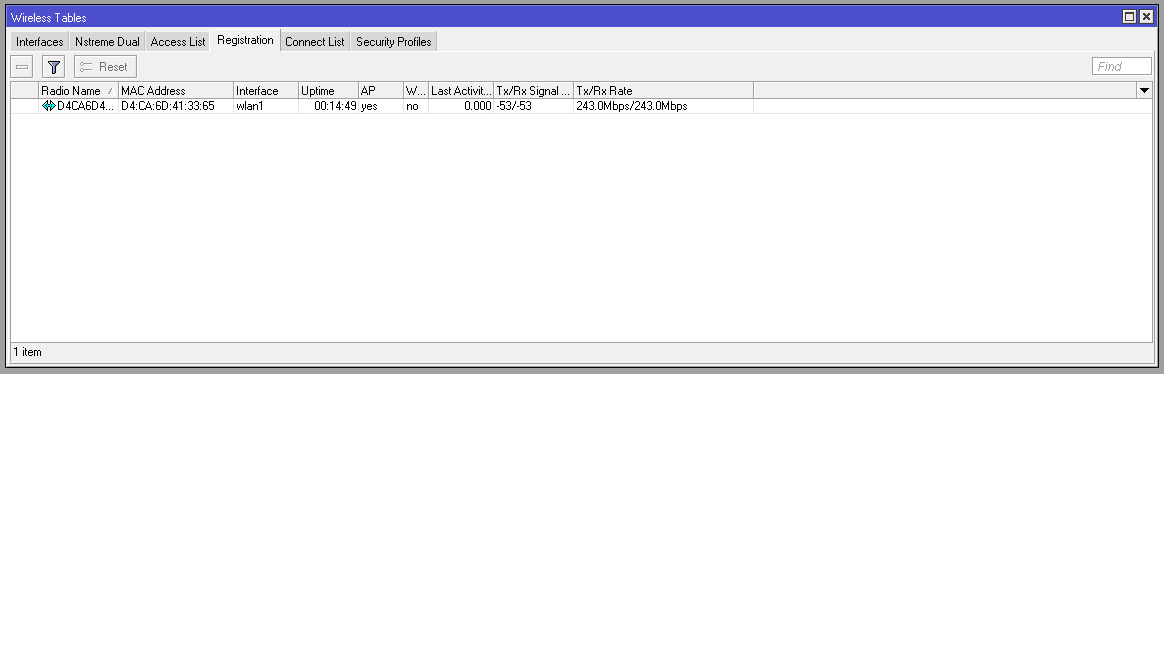

Your signal seams OK.
What’s your Tx/Rx CCQ?
ALSO, are you connected at 100M (your ethernet) or at 10M?
Where and how can I provide you de Tx/Rx CCQ?
Oh think I found it (Wireless | Status) Tx/Rx ccq = 84/90%
I’m 100M full duplux connected at both sites.
Only 100m and you’re not connected at full 300Mbps?
At 100m distance, you SHOULD have been locked at 300Mbps and Tx/Rx CCQ 100%.
a. Try to align once again their antennas looking FIRSTLY the CCQ and then their signal and wait a few seconds on every change you do - BEST IS to draw some data (copy/paste) from one spot to the other to immediate see the changes on the lockage Mbps of them (300Mbps) and the Tx/Rx CCQ of them.

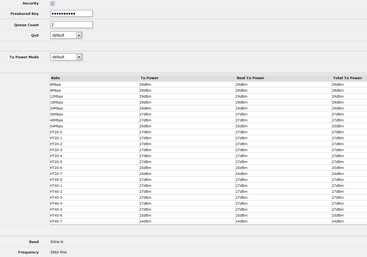

b. Try to lower a bit in BOTH of them their output RF power IF a. doesn’t work well.
No, not 100 meter distance but 100Mbit connection at the Ethernet port.
The distantance between the 2 SXT-5HnD is about 250 meters (GOOD Sight).
How can I lower the TX RF???
In Wireless interface tick “Advanced Mode” and then go down and Tick on “Tx Power Mode” and pick the “all rates fixed” and play with them a bit dB to dB down.
