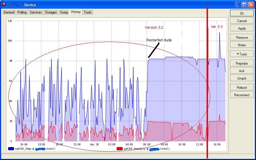

I upgraded to 3.3 at around 1pm MST. So far it looks like it is much better in SNMP collection.
Here is an example SNMP graphic of 3.2 vs 3.3.

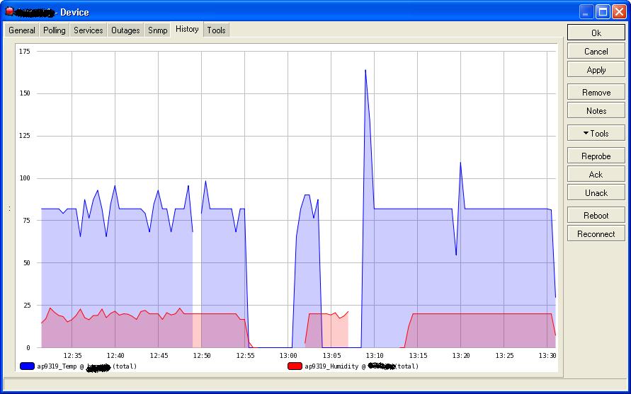

Every now and then, I have “gaps” in my snmp traces.
If I snmpwalk the device during a gap, I can see the data values that are being traced.

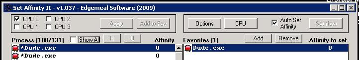

If you want to force affinity you can just right click on the program in task manager. There is a program to force affinity that seems to be a good candidate, it runs at startup etc.
http://www.geocities.com/edgemeal_software/SetAffinity/index.htm
Never mind forcing affinity to a single core does not fix it.
I restarted the service and forced affinity as soon as I could and things have been much better since. I will report back in a few hours. Maybe you should try it as well oscarBravo.
Any way to do that without restarting the router the Dude server is running on?
Yeah open the services control panel… stop and start the service. If it won’t restart then kill dude.exe.
Download “set affinity II” beforehand and as soon as the process is restarted you will see it and set it’s affinity then.
It is supposed to be able to set affinity upon a reboot but I have not tried it.
If you add dude.exe as a favorite it will show up at the top of the list, once you set that as an option in the program so you might want to run set affinity before you start and stop the service…

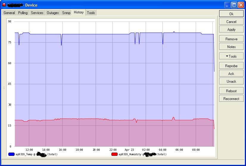

Ok so it looks like dual and quad core have collection issues. With the program added to Set Affinity II and automatically forcing affinity to a single core my graphs are much better. I did have a hickup (many false outages) when I was adding some devices to a submap yesterday morning but restarting the service fixed it, also this service restart was the first one that automatically went to a single core so that might have had something to do with it. So now about 20 hours later things are still mostly clean in the graphs. Much better than with out setting the Affinity.
w2k3 sp2 quad core…
Just a quick update, Since I forced affinity with the program above the collection of all the probes has stabilized I have not seen any false positives and there are no gaps in my graphs.

I have upgraded to Dude 3.3 and started using Set Affinity II to limit Dude to my 1st Core.

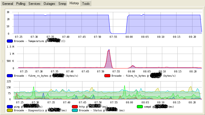

I have less obviously false outages, but there still are some.
All of the false outages involve SNMP - “ping” and probes based on external commands do not generate false outages.
During a false outage, SNMP on the device in question can be walked and the individual oid associated with a failing probe can be requested and a valid value obtained.
CPU% on the Dude server and target device are <30%.
N/W traffic is <1Mb/s on 100Mb or 1Gb NICs.
No errors are reported in any logs (except the false outage in Dude).
Devices are all types: AIX servers, Fibre Switches, Windows servers, Storage Arrays, etc.
I get at least 2 false outages a day. Strangely they each last either 3:00 (20%) or 4:30 (80%).

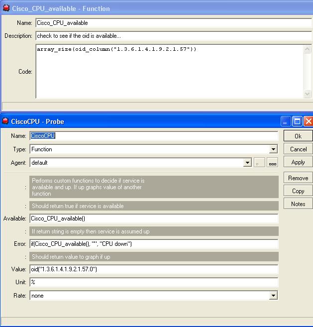

I have a new theory on why probes become unstable.
I am thinking that probes based directly on OIDs and not on functions are more succeptable to become sporatic.

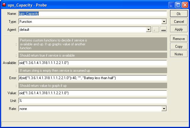

For example the battery capacity probe I made looks like this…
I just converted my Cisco CPU probe to work like this…
I am going to disable affinity forced to 0 and let it go over night. I will let you know as soon as I find out if it stabilizes CiscoCPU vs my other probes built with OIDs.
Hey adamd292, Could you convert one of the probes that you get false positives with into a probe that calls a function that reads the oid instead. Like I did in the previous post.

Never mind with that… What I have found is it runs much better with single core affinity but anytime I add a device either manually or discovered within an hour or so I will start getting random failed snmp reads.
The probe based on a function is better from the standpoint that it will not get added to a device that does not have that counter it also doesn’t show as being down when the counter is actually returning 0 as the result.

I did some quick stats on SNMP Test Probe vs Function Probe with direct OID vs Function Probe that calls functions.
False positives over the past month: (Probes/Falses/Avg)
SNMP Test Probes 4/39/9.75
Function Probes with OID() calls 10/237/23.7
Function Probes with F’n calls 5/767/153.4
