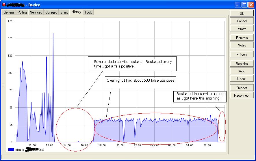

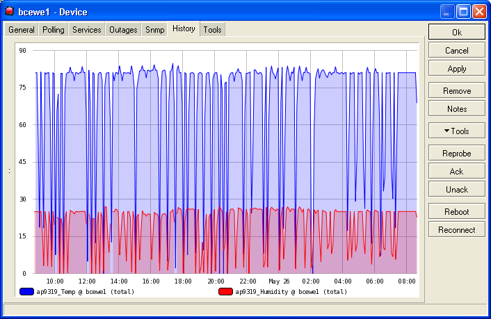

I have tried everything and it seems that if I make a change to any map collection goes screwey a few minutes after and even if I don’t make a change collection goes screwey every few hours. Here are a couple views of the trouble. I just have to restart the service every couple hours. Sadly I can’t use the notifications at all since I have horible counts of false positives. It seems as though there is something wrong with multi-threading as well because graping goes screwey sooner if I don’t force affinity to a single core. Although now I am pinging about 1600 more devices since we want to know how many computers are being turned off over night. Maybe graphing is inconsistent because I am exporting one of my dashboards every 15 minutes?
Does anyone has any ideas about how to get collection to be consistent?

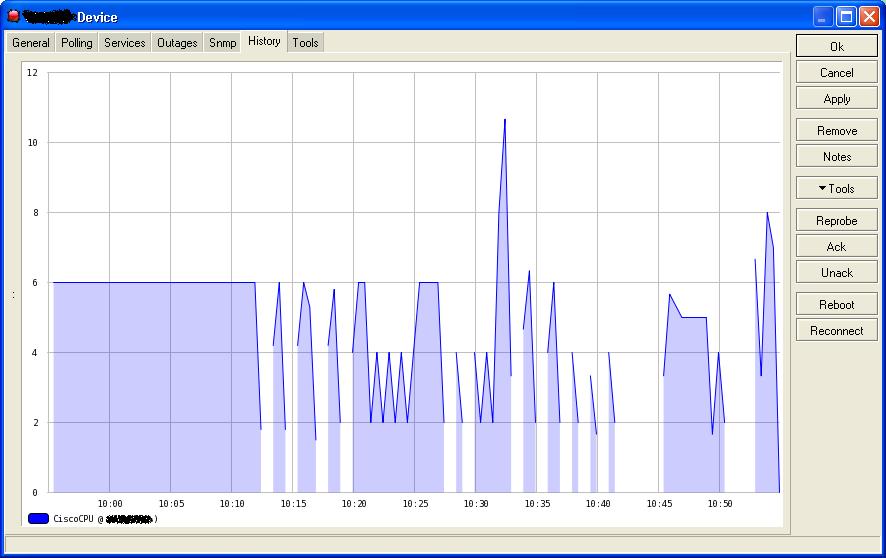

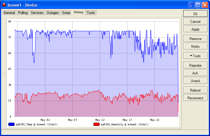

Not all of the graphs made by the Dude are consistent, I understand the spikes to be the result of a missed poll and then a succesfull poll, but I don’t get it why a device which appears to be SNMP-browsable by The Dude SNMPWalk is showing gaps every now and then.

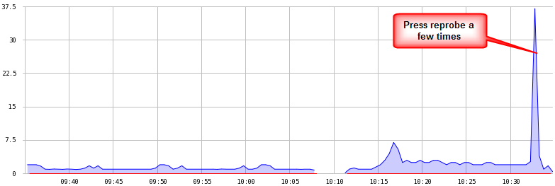

I have found an interesting effect to quickly temporally fix a false positive. When one of your probes shows “down” (false positive) If you open the settings for the device and click re-probe you will notice it will not come back immediately (no matter how many times you click re-probe), edit the probe and change the error portion of the probe either add a space character or delete a space character. Then save the probe and re-probe and it will return to normal instantly.
