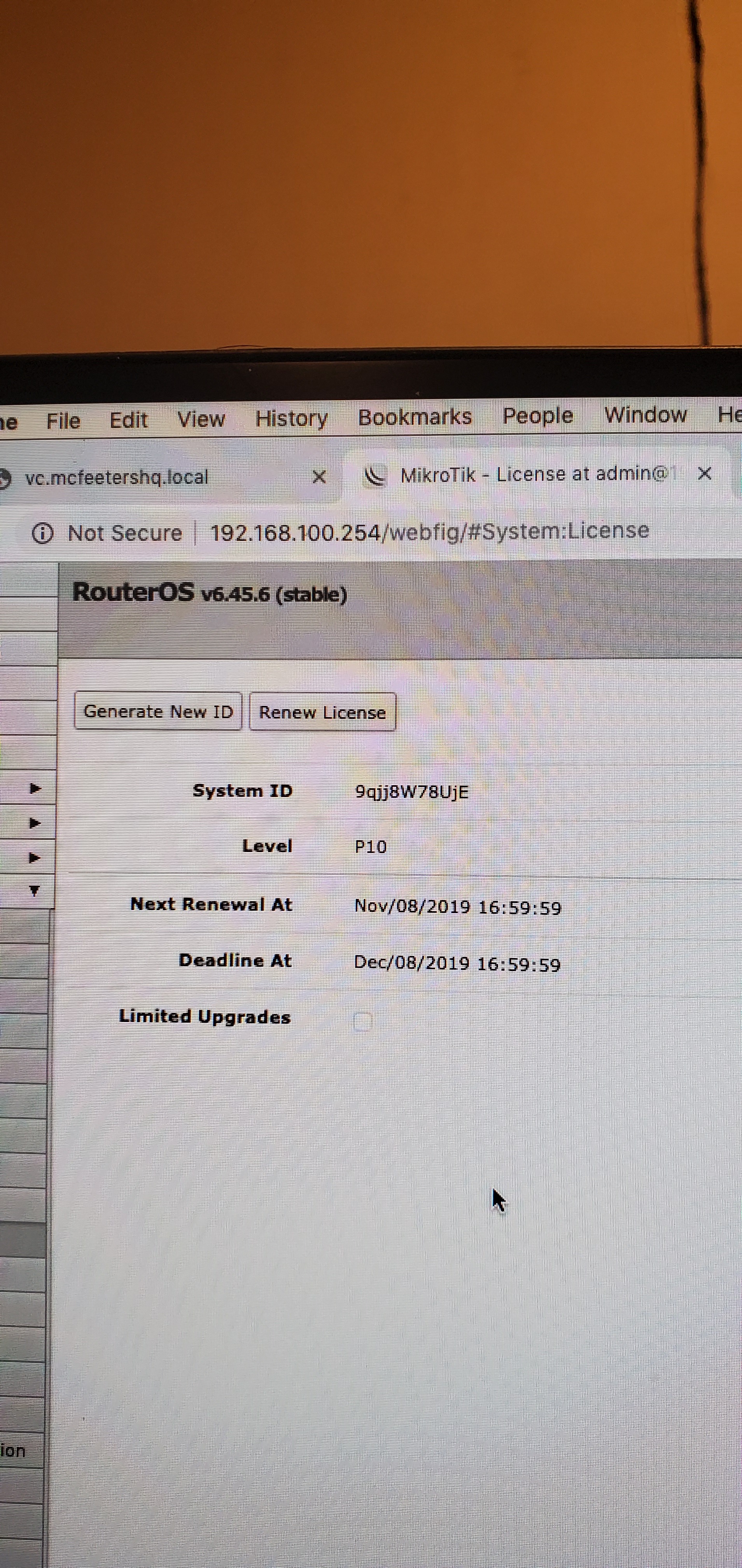

Have you licensed it with a trial license? If not it’s restricted to 1 Mbps throughput and that can def cause latency

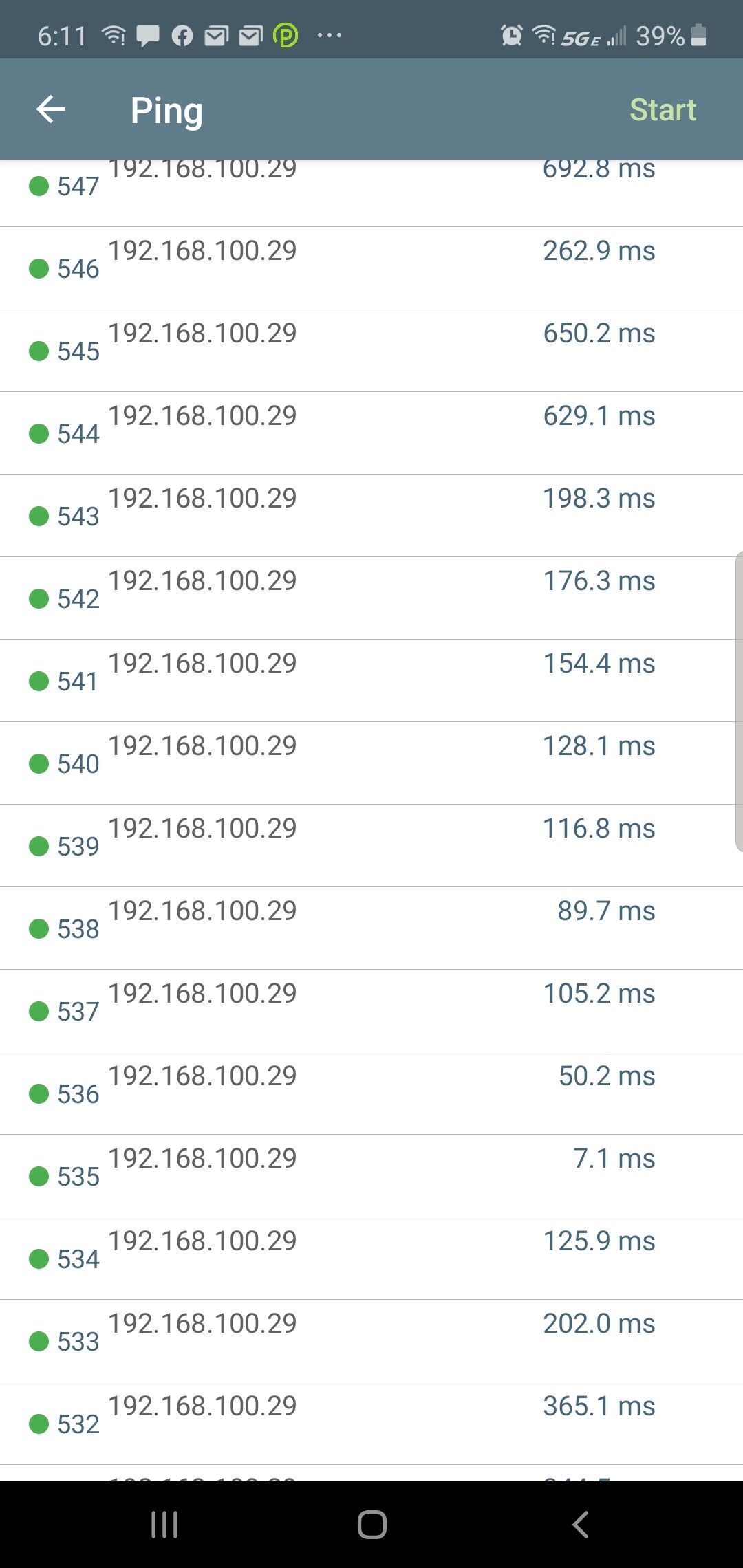

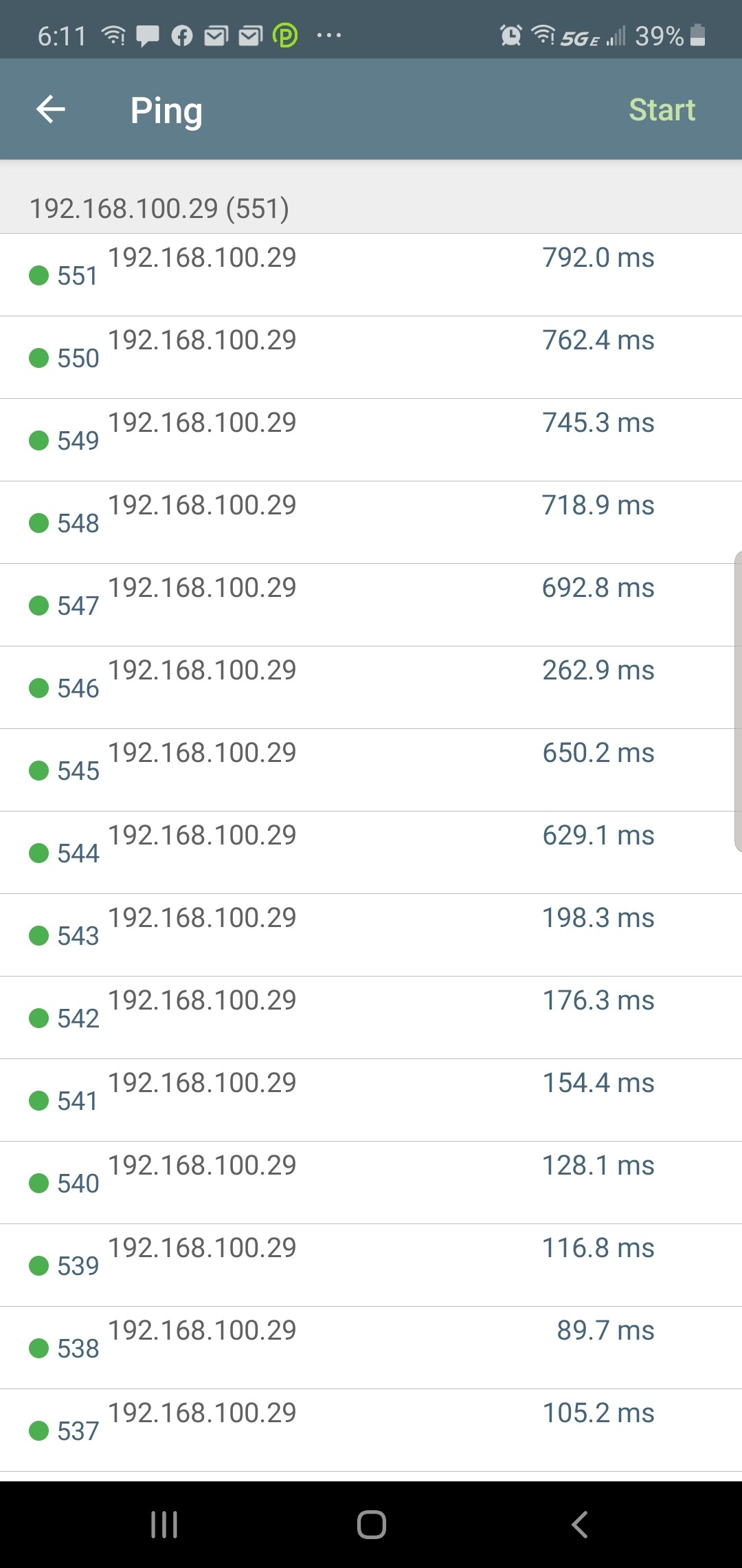

I changed config to a single trunked port broke that to vlans, then added the vlans to a bridge and get slightly better but still off results. So it goes several pings low then climbs then stays high for several pings then starts over.
