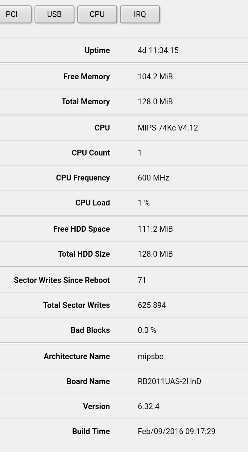

20000 sector writes in 36 hours give something like 93000 sector writes per week. What’s the NAND Flash size in your device?
I have netinstalled 6.45.1 and the issue persists. But the writes are not done once a week, as in the “refresh” update, they are done every couple of minutes. After 1 hour there is already more than 300 writes. So the netinstall procedure hasn’t fixed it. I noticed that even though leases are set to never write to disk, any time a lease is granted, renewed or removed, write count raises by 16. No matter what interval I use, be it never, 1 hour, 5 hours, 1 day, etc, any lease change causes sector writes immediately.
I have already contacted support, they are investigating, so I will keep this thread updated with any info that might help.
128.0 MiB, RB2011UAS-2HnD

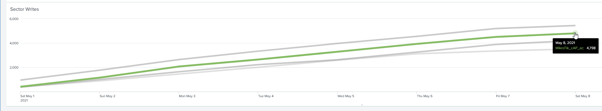

I have 1 cap ac running for 2 years 24x7, it collected 600K (~800 per 24h). After update to 6.48.x this year it got another 90K in 2 weeks, so I started worrying and testing different settings on/off.
Stats for last 7 days with SNTP off (including other 3 MTs at home):
