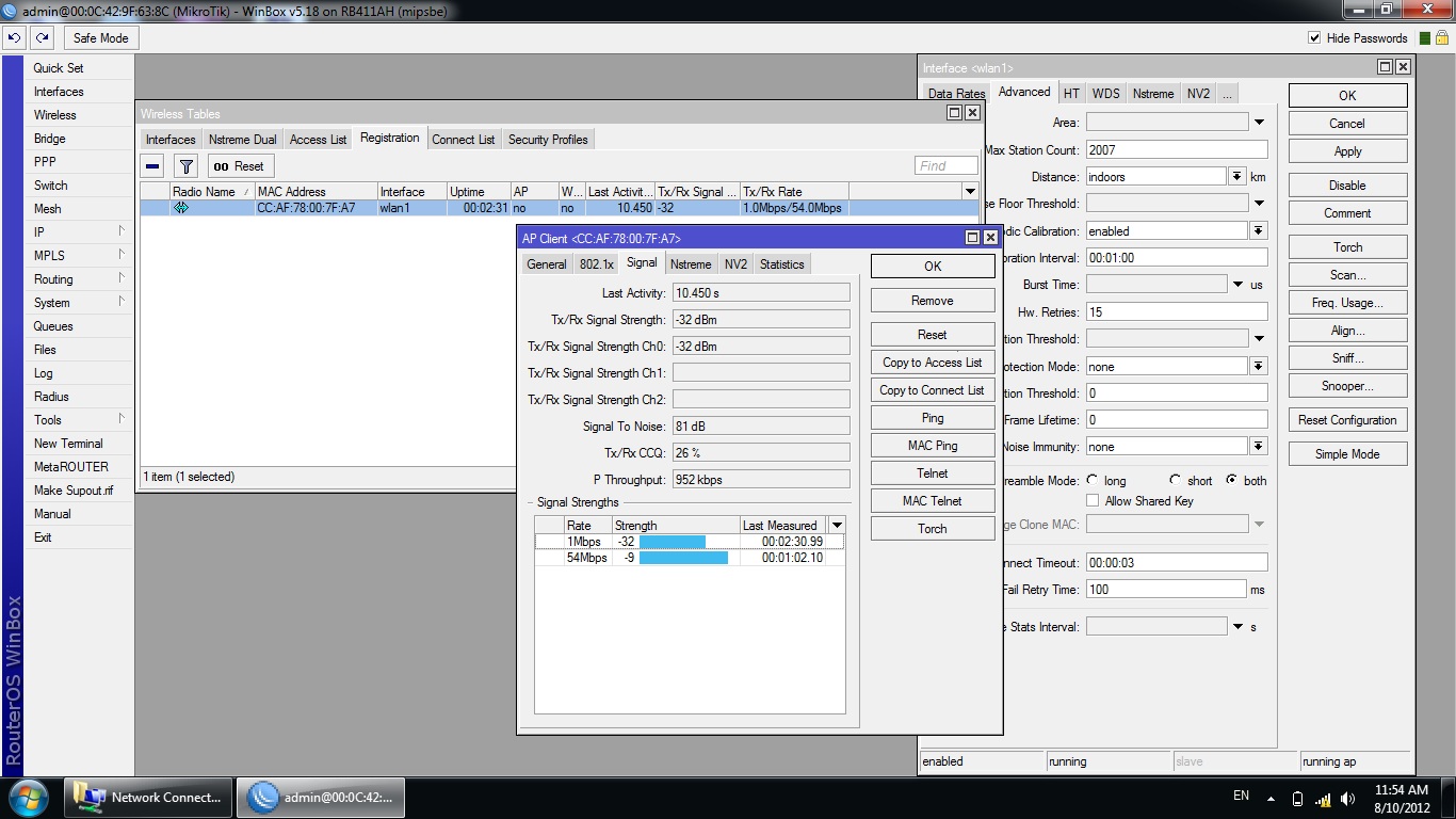

hi
please see attached image
distance is only two meter
whats the problem in tx rate?
your signal is much too strong (-32). try to increase distance to get tx power -50 or -60
i tried tx power from 5 dbm to 17 and then default with no change.
i tried distance about 2 kilometer with no change
only when i enable just G and 54Mbps speed and disable all modes and speed the problem will solved and ccq=90 to 100
but my network is ptmp and i want good ccq and speed for clients that have good signal

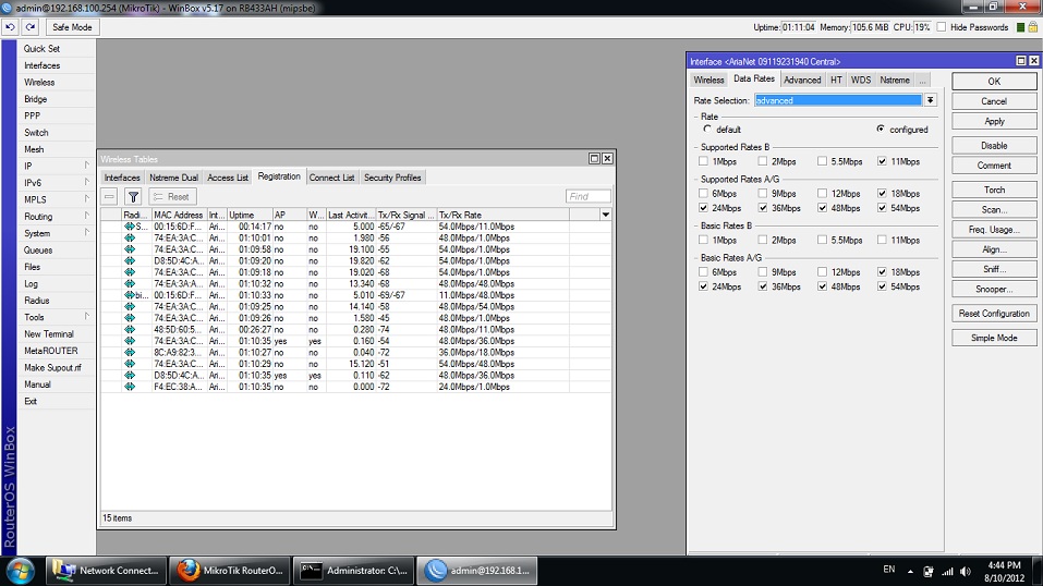

post an image when your Tx power will show -60
this is another AP
I forced to check good speeds and uncheck low speeds to increase ccq and speed
and enable just G mode.
I don’t see CCQ in those images. What do you consider “bad CCQ”? What values do you get when signal is -60?
Why have “uspecified” wireless protocol on the AP?

i checked again and see that speed and ccq goes up after afew minutes
