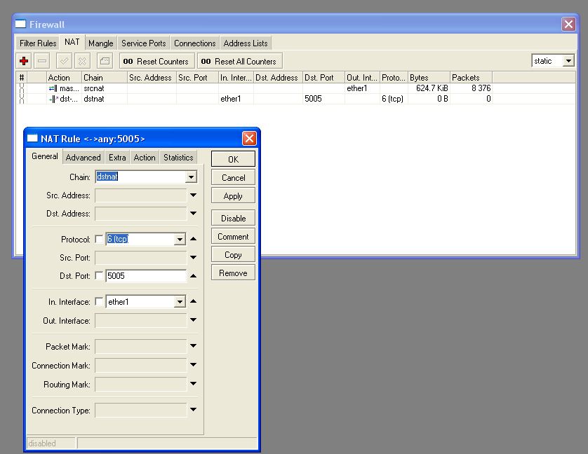

I had a similar problem and was adviced to do the port forwarding in NAT.
to make 5005 open from the outside do this:
/ip firewall nat add chain=dstnat dst-address=69.69.69.69 protocol=tcp dst-port=5005
action=dst-nat to-addresses=192.168.1.101 to-ports=5005
69.69.69.69 being your public IP and 192.168.1.101 being the lan computer with the service you want to provide through port 5005.
rgs Pilgrim

Okay I have tried the following:
Where 192.168.1.1 = my router IP
and where 192.168.1.16 = my PC where the program will run on.
/ip firewall nat add chain=dstnat dst-address=192.168.1.1 protocol=tcp dst-port=5005
action=dst-nat to-addresses=192.168.1.16 to-ports=5005
AND
/ip firewall nat add chain=dstnat dst-address=192.168.1.1/24 protocol=tcp dst-port=5005
AND
/ip firewall nat add chain=dstnat dst-address=192.168.1.0 protocol=tcp dst-port=5005
and it still on all 3 attempts it says that the port is closed off … I even installed a port scanner to check and it says the port is closed off as well.
So that didn’t work so nice :slight_smile: … perhaps any other idea I could try to make this port open for incoming connections???
Regards,
Z

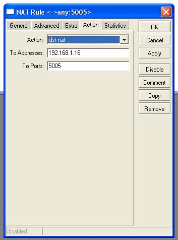

hmmmm
I just made a small test on my router. You can actually just leave out the dst-address. Then you don’t have any problems if your public IP changes. I made two tests one just removing the dst-address and one test replacing the dst-address with the input interface and both of the worked.
e.g. if you have assigned interface “ether1” as public port port the just put in:
/ip firewall nat add chain=dstnat in-interface=ether1 protocol=tcp dst-port=5005
I don’t know how to thank you :smiley: … I will try it quickly and see if it works… thanx so much. … will let you know whether it works or not.
Regards,
Z
AWESOME !!! it worked … thanx man … this is great … will just test the program now … I used the interface option and it worked … port scanner reporter the port to be open … :smiley:
thanx for ALL your help!!!
Regards,
Z
