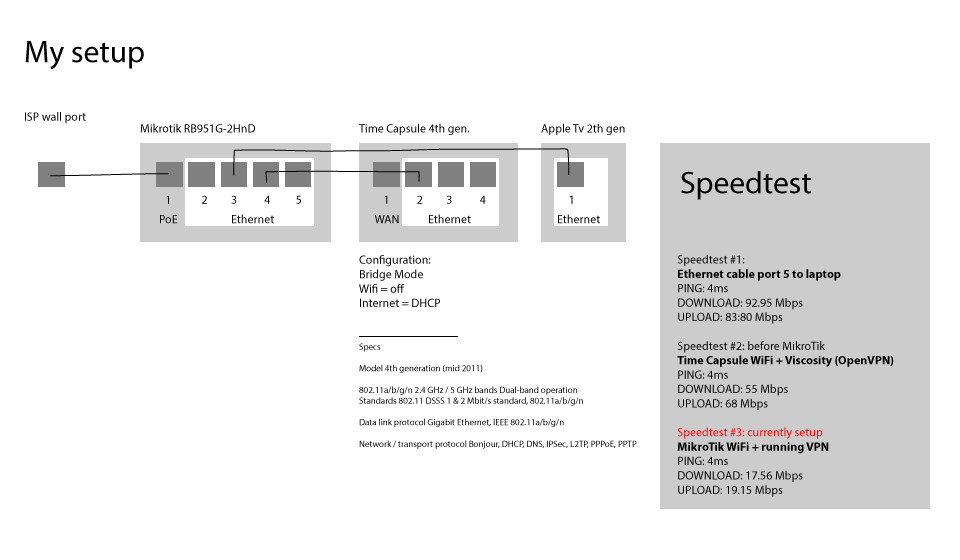

I guys, i’m completely new to this. So I apologies advance.
The thing is, I only used my Time Capsule 4th gen in the past. But i’ve I setup a MikroTik RB951G-2HnD as router. I just used the Quick Set configuration. And I haven’t changed anything. I’ve connected the Time Capsule to the RB951G-2HnD as a bridge via ethernet cable (port 5). I’ve got some part of my iTunes media files stored on the TC. But now transfering files to and from my laptop and Time Capsule takes forever. And I can’t stream to my Apple TV, just keep loading.
It’s weird, because i have a fast connecting. And I had no problem before i started using the MikroTik. Something is clearly wrong in the setup, but I don’t know what and where. I could just disconnect the MikroTik and go back too how things were, but I need RouterOS to run OpenVPN.
But i’m thinking that it might be better to perhaps set the RB951G-2HnD as bride and leave the TC in charge of creating the wireless network?That the TC is a better wireless device.
I’m in doubt about the right direction. So if somehow to point in the right way, I would be thankful.
And I will provide you with logs, just tell me what you need.
(RouterOS 5.26)
Thanks.

Could you please post your configuration, removing passwords etc?
Tony

Sure Tony.
Can you use this? Or do you need something else.

About my connection speed. Quote form my IPS’s website:
“The connection has no maximum limitation. This means that you can experience speeds higher than 50 Mbps., For example. 80 Mbps or 500 Mbps - depending on the equipment you are sitting on.”
And i’ve attached a quick illustration.
