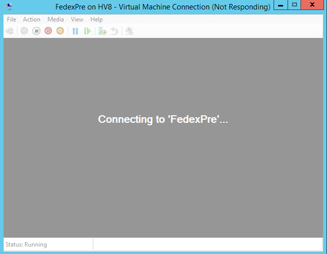

2, Hyper-V manager open a VM very slow, stock “Connect to xxx”;
