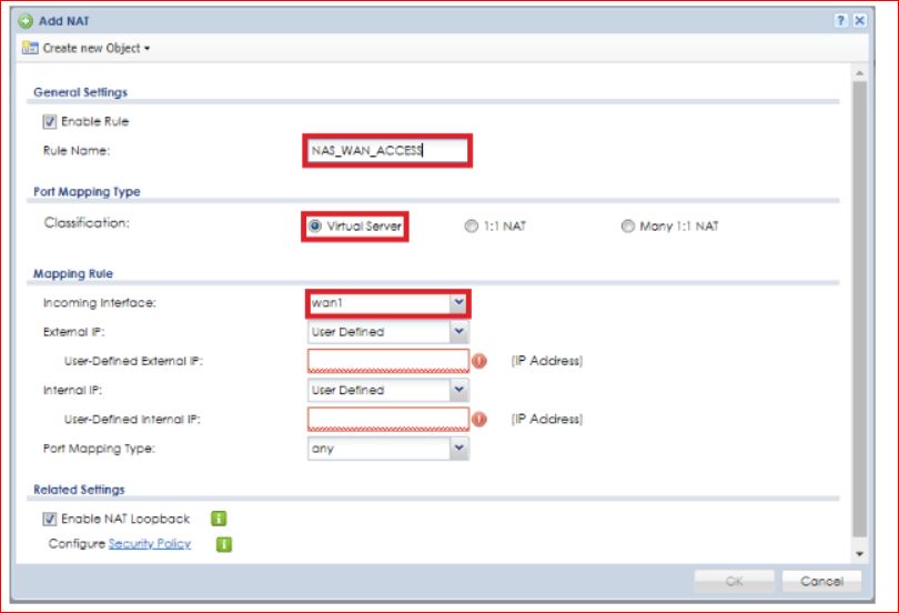

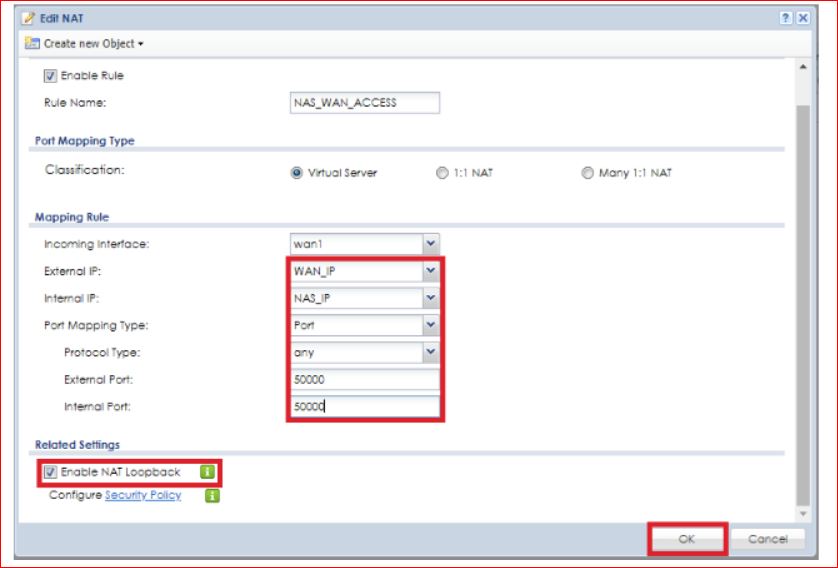

Yeah, it seems that I underestimated the complexity of networking stuff. I start to see what I want to accomplish more clearly. The deal is, there was a thing called “Virtual Server” on old router. There’s it’s settings: (had to edit some values because they were shown as text, so-called “Objects” (aliases) of USG40W)
That is just normal port forwarding on a zyxel router.
External IP is the routers WANIP
Internal IP is the IP of the server
External port is where it comes in on
Internal port is what its translated to
The main difference is that on a zyxel router one needs to define a firewall rule for every port forwarding rule.
The bottom jpeg shows the basic view, the top jpeg uses defined objects for some of the entries.
What is cool is that NAT loopback (hairpin nat) is a simple checkbox LOL. Easier yes, but in Mikrotik one gets to know why and how its done.
