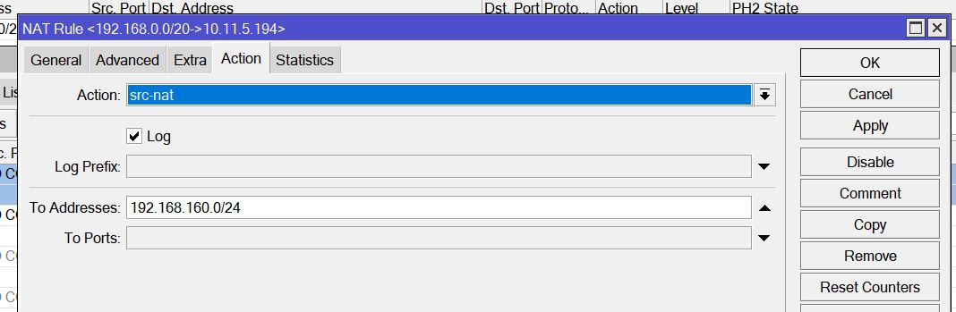

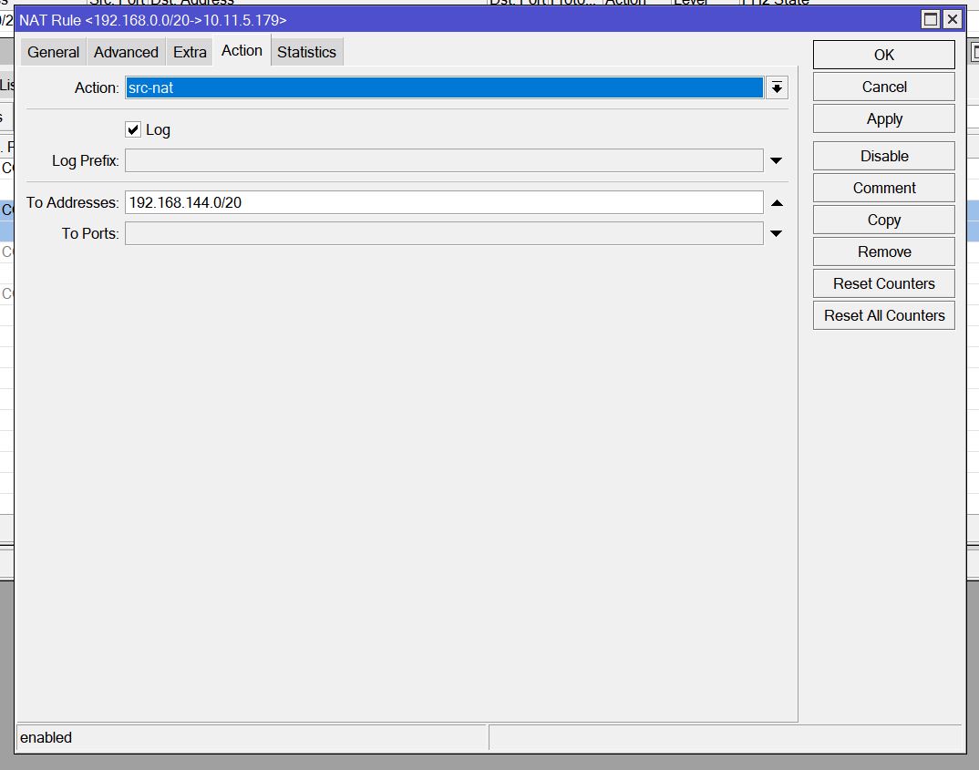

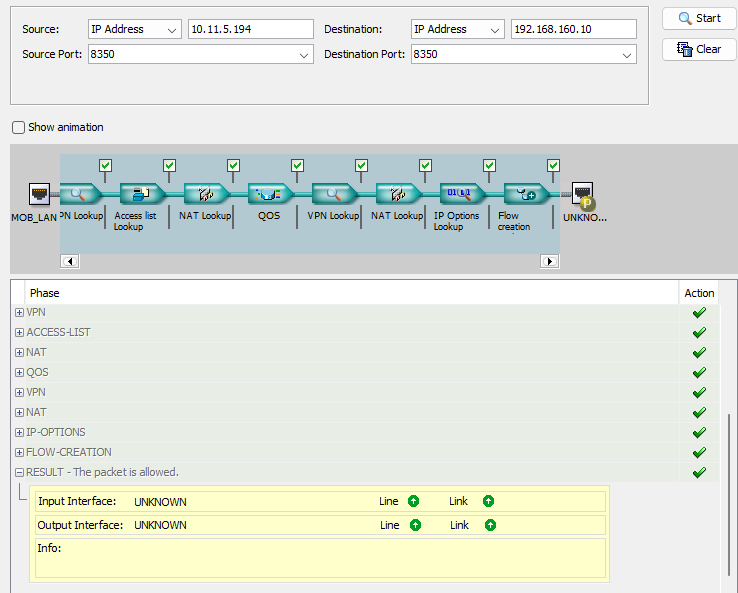

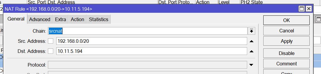

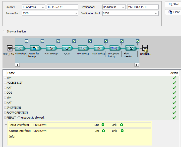

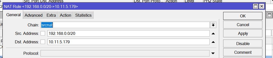

I attach the configuration image and the routes configured on the NAT
I report that the problem is mine, there is no problem in Cisco
Any suggestion is welcome
Thanks for your support

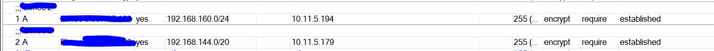

First of all, change the level parameter of both policies from required to unique. If that does not help, we’ll dig further.
Since you’re using the same subnet as someone else on the Cisco side you’ll need to use src-nat. Btw, why not use 192.168.160.0/24 since the Cisco admin already assigned it to you.

To access the IP 10.11.5.179 I used the virtual subnet 192.168.144.0/20
To access the IP 10.11.5.194 I used the virtual subnet 192.168.160.0/24
Both subnets were configured on the CISCO (not by me but by an external company)
I set the NAT addresses, but one goes at a time, if one works the other does not.

If I set it to REQUIRE A UNIQUE I solve it.
Can you tell me what this entry changes?
I may be wrong here, it’s only my own conclusion from observing the behavior, as the desrciption in the manual says something else (or maybe the same but in a pythic wording): if you have two policies between the same peers, require allows to use the same pair of SAs to deliver packets matching to either traffic selector, whereas unique makes sure that for packets matching a given selector, only the SA dedicated to that selector will be used. Since the receiving side also compares received packets to traffic selectors, the approach must be the same at both peers, otherwise the peer that is set to unique drops packets that came via the “wrong” SA.
