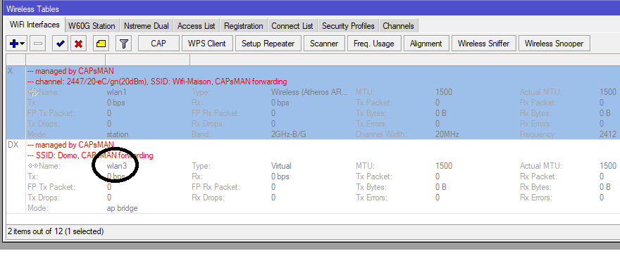

i have capsmanager with 2 lan.(2 ssid)
When i connect caps , i have 1 caps (wlan1) with wlan1 and is name is wlan1 and se second wlan2 .
when i disconnect caps, i have 1 caps (wlan1) with wlan1 and is name is wlan1 and se second wlan3 ,etc…
how i can do for the caps stay wlan2.

I would like to know how to prevent the incrementation of 1 when a virtual wifi interface is created.
ex:
i have a wlan2 virtual interface i am suprising and recreating it.
it takes the name of wlan3 and so on.
How to prevent this

thank you for the answer .
But it’s not at the level of the capsmanager but the cap.
I put an image to see.
This also happens when there are no even single point headers accessing the interface incrementing by 1 if I delete it and re-create it.
thank you
I was asking for the output of capsmanager because my guess is that the old “wlan2” interface is still listed there (but not visible on the cap since it is not active anymore). That means if capsman still knows about “wlan2” he will increment this number for your newly created interface and name it “wlan3”. Please post the output of my previously mentioned command so that we can check this
