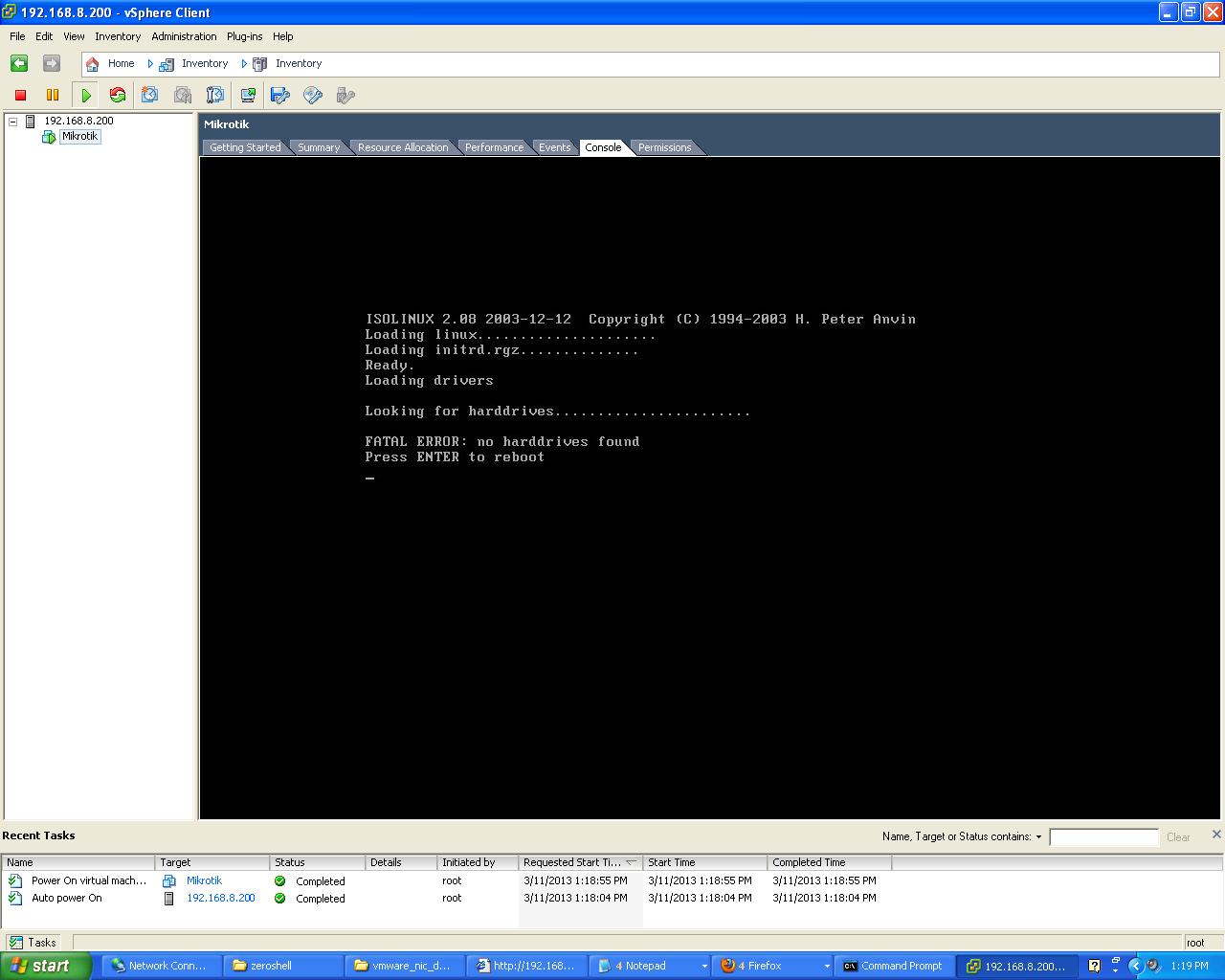

When installing the mikrotik v6.0rc11 in vmware 5.1, no drives found.
Any advice?
Please see attached.
Thanks,
Leon
Try adding Hard drive as IDE in vm guest.
Sir,
Still no harddrive found.
How to add the hard drive as IDE in guest OS?
Thanks,
Leon
Ok.now installing
