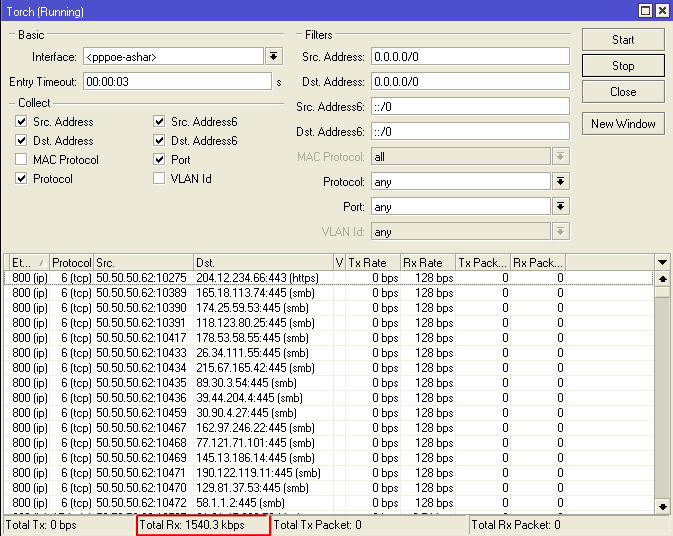

I’ve monitor my infected users by using touch tool.. the result is in given attached screen shot.
Please see the screen shot and suggest me what to do?

As I said before this type of arbitrary port blocking is an amateur’s solution. Target specific behavior not ports. I know I said arbitrary filtering is generally bad practice but what you have is a worm actively attacking other machines, not something like spam. If it’s an active attack filter it to protect users on the other end. It would be something like this.
/ip firewall mangle
add action=add-src-to-address-list address-list=Worm-Infected-p445 address-list-timeout=1h chain=prerouting connection-state=new disabled=no dst-port=445 limit=5,10 protocol=tcp
add action=drop chain=forward disabled=no dst-port=445 protocol=tcp src-address-list=Worm-Infected-p445
That way legitimate use isn’t blocked but something like a worm sending out mass amounts will be detected and stopped. You may have to play with the rates a little as I don’t have traffic to test on, but that’s a much more elegant solution than blocking a bunch of ports for all users. Yes, this could be done with a rate specific firewall rule, but this gives you a nice list of user IPs that need to clean up their machines.

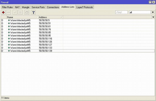

Along with the other rules it means 5 packets per second with a burst of 10 specific to new connections. The mangle rule will put addresses on a list when it exceeds that limit. You can just use that rule and tweak it until you’re satisfied with what it detects and then you can apply the firewall one.
I have found some IP’s you can see in screen shot.
now which rule i should apply for them?

Your advice is fine. I have not tried it but is worth thinking over. However I had a few queries. The mangle u showed is for “tcp” only but we know that UDP ports are also vulnerable.
Also, after the IP’s have been identified as in asad’s list in the picture 4444.jpg does it only identify the IP’s or drop the worms spreading from the IP’s.

The mangle rule identifies and then the firewall rule drops the traffic from detected IPs.

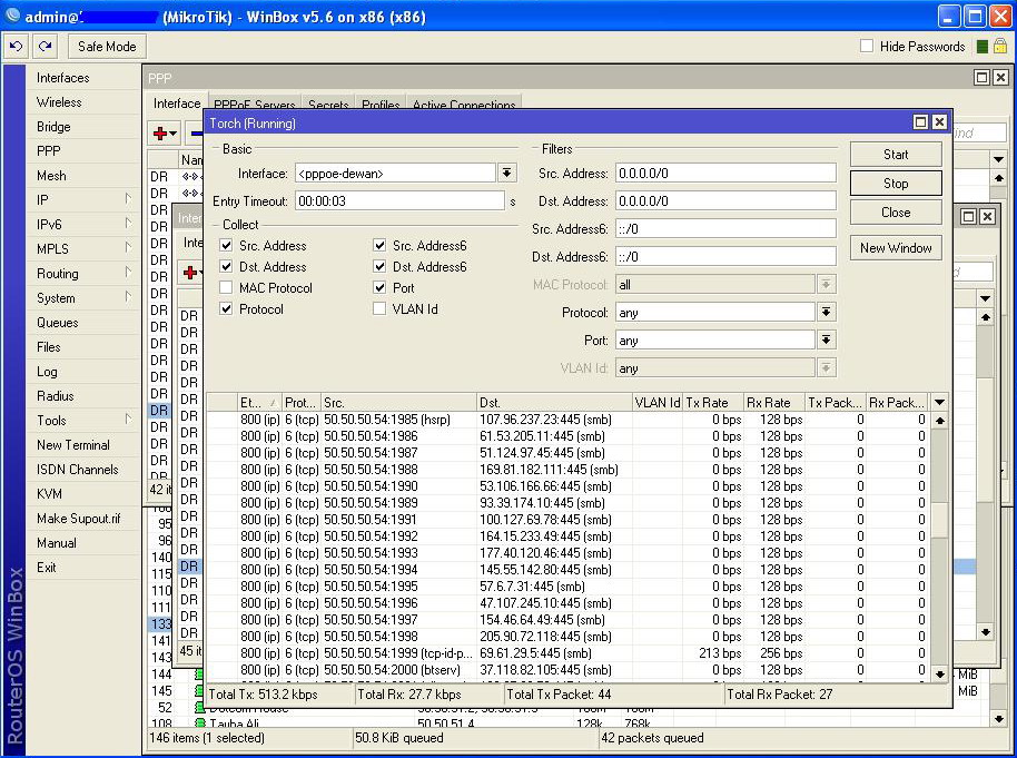

Dear MCT,
I came here with my new problem, i hope you’ll help me to solve it as you’ve done before.
I am attaching the infected user screen shot, I’m using firewall rules as you suggest me before but my one of user continually spamming and main thing i have noticed that i gave this user 64k uplink in queue but he’s still spamming on 1.5mb uplink.. why its happening?? does my firewall not working or what else??
Please find out a way for me…
thanks
best regards
50.50.50.62 has some virus - just find’em and punish’em!
p.s. if you see this in Torch - it doesn’t mean that it’s not blocked by Firewall filter
