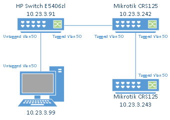

Hello, my situation is the next:
I can access to manage 10.23.3.243 bridge since 10.23.3.99 and is impossible to manage 10.23.3.242.
Two bridges are the same configuration.
Nobody can help me?
Thanks.

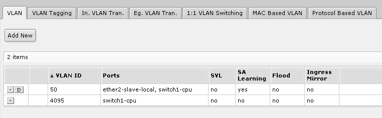

Is cpu port member of VLAN50 on 10.23.3.242?

Maybe this will help:
Wiki says:
Configure the port which connects switch-chip with CPU, set “vlan-header=leave-as-is” because management traffic already should be tagged
and
Since the master-port receives all the traffic coming from switch-cpu port, VLAN has to be configured on master-port, in this case “ether2” port
In your screenshot ether2 has “slave” in its name. Like Sob said , export your switch configuration. It will tell us where the problem could be. Like this its just blind guessing.

Quick look into your configuration and i can see you did not set Admin MAC for bridge.
Please set admin MAC to bridge infterface on both switches.
But I dont know why you even created a software bridge as you only added ether1-master interface in this bridge?
I would remove bridge and add VLAN50 interface (/interface vlan add) ontop of ether1-master-local
Also add switch1-cpu to VLAN table:
/interface ethernet switch vlan add ports="switch1-cpu" vlan-id=50
/interface ethernet switch egress-vlan-tag add tagged-ports="switch1-cpu" vlan-id=50
