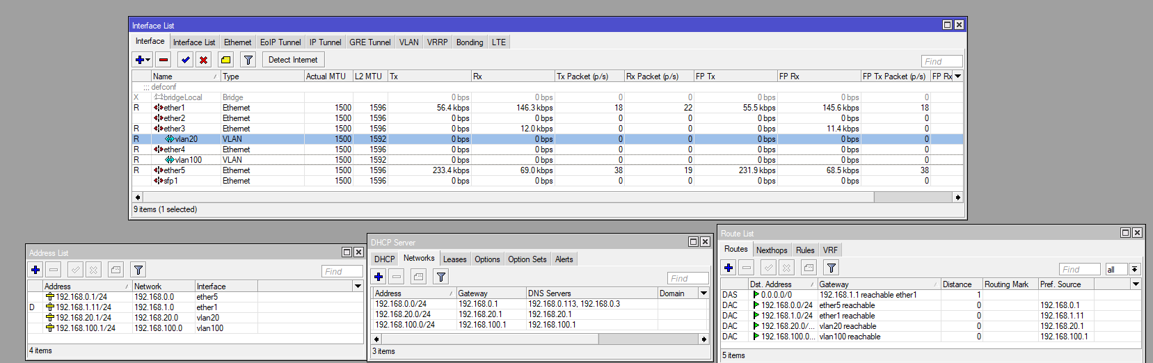

This is my setup in the RouterOS:

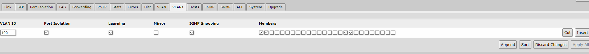

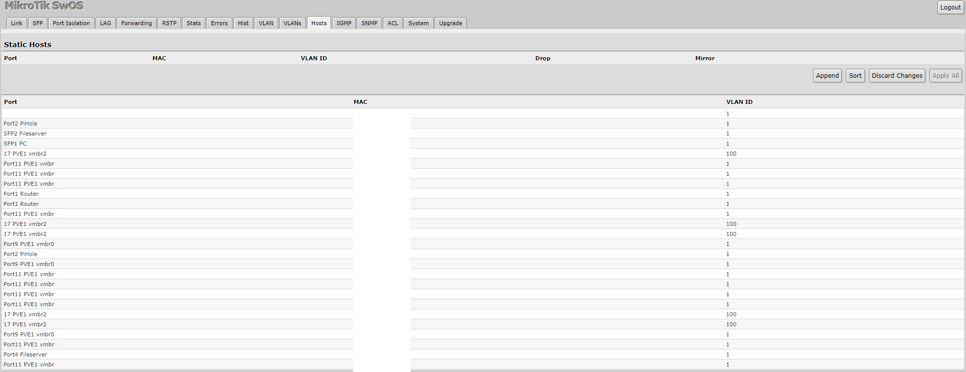

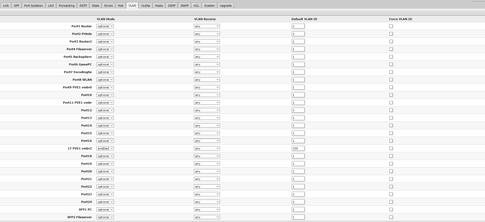

and this is the Switch:

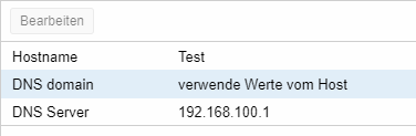

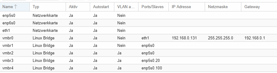

And here you can see my PVE-Setup:
But the Test-LXC doesn’t get a DHCP-IP nor can it ping google.com

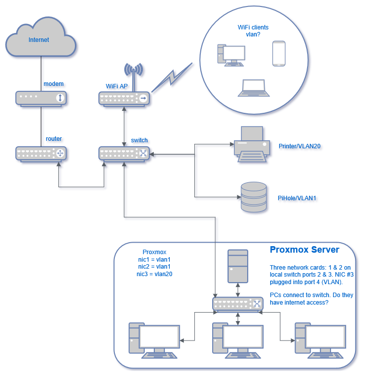

You want us to design your VLAN, that is understandable because with MikroTik, you would have needed to be reading about it for several weeks by now. If you want help around here, then start off with a really nice shiny diagram of what you envision your network should be.

Your diagram helps, a little, but it does not match your written description. Also, I don’t know how to configure the CSS326 switches, only the CRS326 (note the R) versions. However, I believe I can talk you through the correct MikroTik terminology none the less. Also, I believe that what you are wanting is not the best approach. So, now that I understand your goals a little better, I will make you a better diagram.

Here is where we can start the discussion from. I have created a sample diagram for you to work with and edit. Download it and load it into the draw.io website.
Notes:
router = HexS
switch = CSS326
WifiAP = ?
Another switch = ?
Update the XML diagram with VLANs as you see fit. Also make corrections about how the Proxmox server connects to local PCs. Is there a local switch there? Probably should be, or does both the Server and all its clients connect to ports on the CSS326 switch?
VLANS:
For each VLAN, you will have a different subnet, so VLAN10 = 192.168.10.x, VLAN20 = 192.168.20.x. When desiging vlans, note that there is always a native vlan (VLAN1) in a vlan network. This will be, I assume your 192.168.0.x network.
Connections:
Router ether1 plugged into the modem. Router ether5 plugged into Switch ether1. Everything else is plugged into free ports on the switch.

I plugged the NIC of my webservers into the router (eth4) with an own address (192.168.100.0/24) without VLAN and it works. Thus, the problem must be something with SwOS and/or Proxmox.
