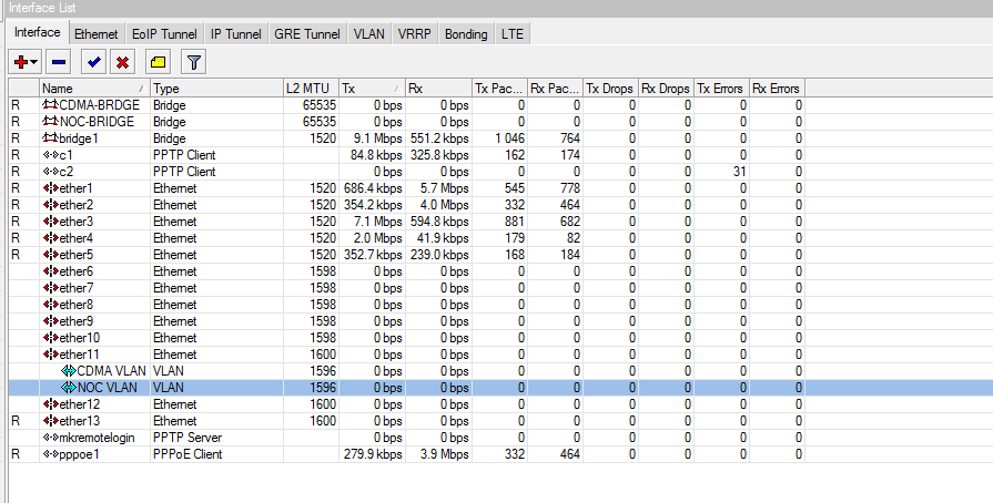

Site A (RB1100AH) 10.10.70.1/24
Nano Bridge on Port 11.
I created two VLANs on Port 11
VLAN-CDMA: ID 10
VLAN-NOC: ID 11

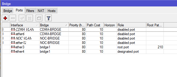

I created two Bridges:
  1. CDMA-BRIDGE: int VLAN-CDMA + Port 6
  2. NOC-BRIDGE: int VLAN-NOC + Port 12
I will assign 10.10.70.1/24 to CDMA-Bridge and attached other devices in that network to Port 6
I will assign 10.10.80.101 to NOC-BRIDGE and add a route to that interface to get to the NOC.

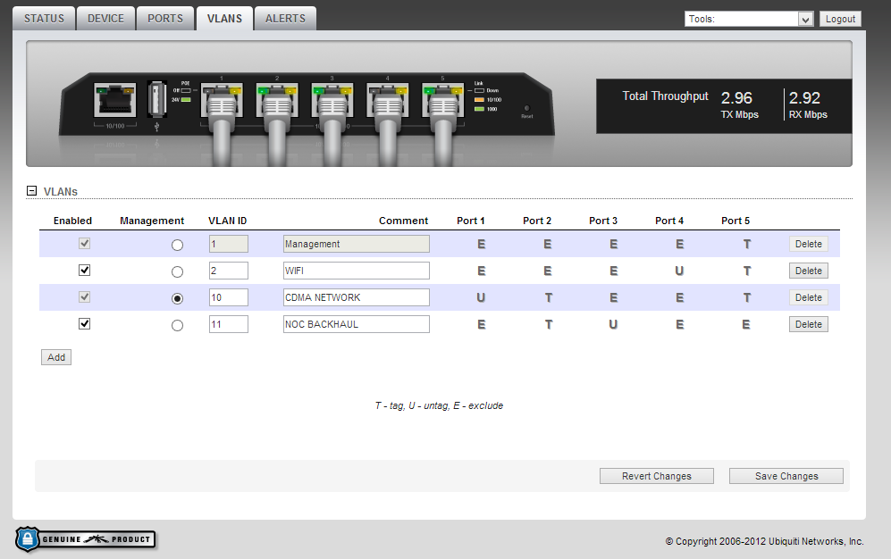

Site B (Ubiquiti TS):
Nano Bridge to Site A is on Port 2
Rocket Bridge to Site C on Port 3
I created two VLANS: VLAN 10 and VLAN 11.
Port 2: Trunk Port VLAN 10
Port 2: Trunk Port VLAN 11
Port 3: Utag in VLAN 11
My setup above works well. Only issue is I can no longer connect to the nano Bridges that links the two sites. Do I have to enable VLAN Management on the Nano Bridge?
Any advise welcome.
