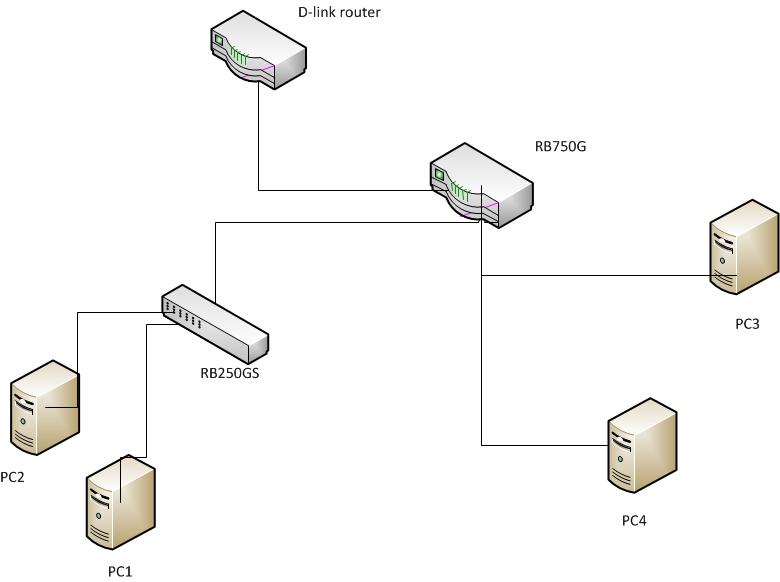

i’m stuck with following problem:
i have two devices (PC1 and PC4) who needs to be in VLAN and access internet, they have ability to tag packets with VLAN ID. There are other devices such as computers (PC2 and PC3) who don’t need VLAN but need access to internet.
My hardware is one RB250GS and one RB750G.
I’ve configured on RB250GS VLAN, on RB750G created VLANs on eth2 - eth5 added those VLANs to the bridge. eth3 - eth5 is slave ports of eth2.
All seems to work with one problem: computers not in VLAN see each other and can access internet, devices in VLAN can see each other but can’t access internet.
What i need to add to the bridge to have VLAN devices see internet?
My network diagram:
Check your gateway and make sure it is reachable by the VLAN interface also. I mean, it looks like your VLAN is working fine but dont find a route to the outer world.
