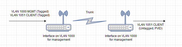

I wand to achieve the following setup:
I am using a Wireless Wire kit.
There is a loop both devices, but for the first step i am just showing the config of the firest one.

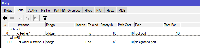

Bridge ports looks like this:
Bridge Ports does not show ports already part of the bridge when they are offline. How can i make them visible?
For example, when there is no 60G connection, it isn’t shown in the list.

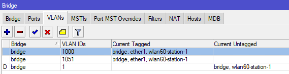

Bridge vlans like this:
Why do i have to add the bridge itself to the bridge as tagged?
Why do i have to add ether1 and the 60g station to the vlan as tagged, when the bridge is already part of it?

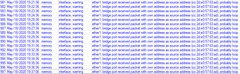

Where is the fault in my configuration, i geht the following error:
“bridge port received packet with own address”. It also occures when only the second Wireless Wire is powered off.

Which is showing the following error:
ether1: bridge port received packet with own address as source address (cc:2d:e0:57:63:ad), probably loop

Which shows this:
wlan60-1: bridge port received packet with own address as source address (cc:2d:e0:57:64:29), probably loop

The configuration has an incorrect VLAN configuration. You diagram shows the master ether1 carrying VLAN 1000 and 1051 tagged, but you have configured the port has VLAN 1000 untagged. It should be:

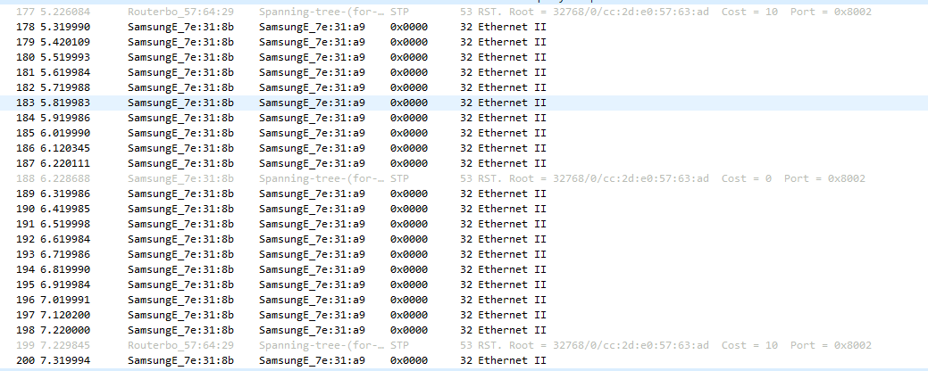

Looks interesting, but do not know, why this happens:
By default it will capture everything - including broadcast/multicast traffic from the rest of your network and the Winbox traffic to and from the Mikrotik itself. You can apply filters to reduce the scope of the capture and hopefully volume of packets, there should be something transmitted and received once a minute looking at your logs. At this point you can examine the packet which will hopefully indicate what the traffic is and shed some light on why it is reflected back.

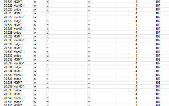

That is the only think, i captured. I also noticed some strange traffic from my notebook to the Wireless Wire, without beeing connected to it.
The other strange thing is, that i do not know what this SamsungE device is. Do you have an idea?
