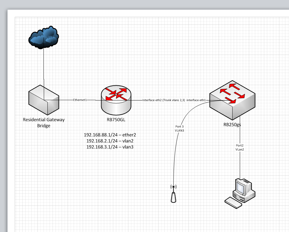

Anyway I’m trying to complete the following configuration based on the scheme here but believe I’m having issues with vlan trunking or tagging. I want to trunk between the 750 and 250 and have the 750 route the vlans. Just like a router on a stick scenarios I’ve seen but seem unable to get these to work.
I get it setup like I believe it should. But when connecting the links I lose connectivity to the switch 192.168.88.2. I feel like it’s a vlan/trunking issue but not sure where to go from here. Config/diagram are provided.

RB750GL configuration appears to be fine. Please check the following example on how to configure 802.1Q Trunking using SwOS
http://wiki.mikrotik.com/wiki/SwOS/Router-On-A-Stick
Thank you for the reply. SWoS config looked pretty straight forward and I have that here. Still unable to get vlan trunking working appropriately. I should be able to ping the vlan interface 192.168.2.1 from the device on SW250 port 2. I am able to ping the SW250’s ip 192.168.88.2 from a device on the switch which would be on it’s same vlan.

Well it is working now. I moved the trunk interface on the RB750gl to interface 3 and then tried interface 3 without a master port and they are working great. I need to take a look at the wiki to see what the differences and needs of each now. But I think I’m on the right path now. Thank you for the response.
