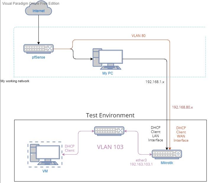

I’m sorry, I was hasty to post my config, I should have given a more detailed explanation.
I’m working in a virtual environment and this is just a test config to learn VLAN with Mikrotik devices.
The LAN interface is only to reach Mikrotik CHR from my network.
This is a diagram of the environment.

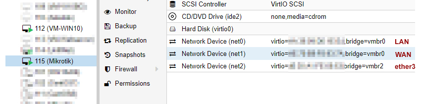

Mikrotik is a CHR version running as a virtual machine, like the VM, both running on a Proxmox system.
I hope I haven’t made too much confusion :slight_smile:
Nope but please clarify if you are trying to mimick an MT device as a router attached to an ISP modem.
Or if you are simply mimicking an MT device as a smart switch in a network.
I would like to mimic an MT device as a router
Thanks!
So the WLAN you are mimicking comes in on vlan80
Okay dont know what you mean by dhcp on only one of the interfaces, that is not a use case description, that is an assumption of a configuration change based on an uncommunicated use case.
What do you have for users/devices or groups of users/devices,
what should they be able to do OR not do…

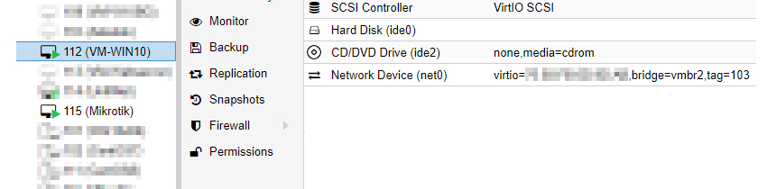

I configured a RB760iGS and it’s working like a charm.
I don’t know why on Proxmox system there is no IP assignment, however, it was only a test environment.
