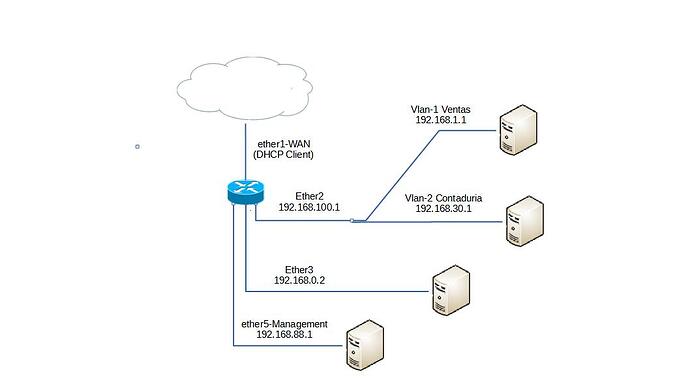

Please refer to the scheme I have attached in a previous post.
I want the Vlan-2 to be a subnet for the Accounting department, and to be separated from the rest of the company, which is connected to the Vlan-1
If the subnet Vlan-2 could be physically conected to one of the router’s hardware interfaces, and the Vlan-1 to another, then that solution would make the “software” much easier.
Unfortunately this is not posible, therefore I thought using VLANs for each subnet
But I am stuck, because the DHCP Server attached to the VLAN does not assign IP addresses to the PCs
Thanks in advance

So you are configuring the network drivers on the PCs to use VLAN IDs 1 and 2?
The scheme isn’t complete, it doesn’t show switches. Did you configure vlans also on them? Use tagging or not on proper ports?

I did not, you are right
But the switches I use are kind of dumb devices, what were called “hubs”
I don’t know if VLANs are the right solution for my problem
What I need is to have 2 subnets that are conected to the same ethernet interface of the router.
Thank you
This isn’t possible. Or, it actually is partly … you can have two IP addresses set on single router interface (for different subnets). But you can’t have two DHCP servers.
One DHCP server can issue static addresses for the multiple subnets attached to an interface, however it can only issue dynamic addresses from one pool as it has no idea how to differentiate which clients should be associated with which subnet. (Actually there are mechanisms which allow matching on vendor ID to select alternate pools, but this is unlikely to be of use for general networks with a variety of client devices).
