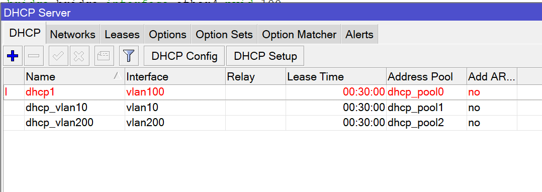

Currently vlan 100 is not configured, because if I change PVID on any bridge port from 1 to 100, no connection works and devices don’t get IP address.
I created separate dhcp for each vlan only vlan 100 is not working.
My other assumption is that the bridge interface is not correct for dhcp1 (which should belongs to vlan100), but when I change the interface to vlan100, it’s not working, and dhcp1 marked as red in Winbox.
Can you help me what did I miss?

Try delete entry for vlan 100 in bridge/vlan tab, and after this set pvid on ports.
When adding the entries under /interface bridge vlan you also need to add the “bridge” to the list of tagged ports. Otherwise, layer 3 features won’t work. In this case the “bridge” port acts as the CPU port.
Added bridge to vlan100 and set PVID 100 on interface eth4 and eth5 for testing, but clients didn’t get valid ip.. (169.254.210.251) Also tried to set vlan100 for dhcp1 inerface, but that is still red..

Why you have add bridge=bridge tagged=ether2,ether3,**ether4,ether5,**bridge vlan-ids=100
I guess that you have clients there and not another switch, so they should be untagged, not tagged
In addition to what @GabrieleV wrote (moving ether3 and ether4 to the untagged list after setting PVID). Did you also move the /ip address entry for 192.168.95.1/24 from the interface “bridge” to “vlan100” before changing the DHCP server entry?
Hello!
Appreciate your suggestions, they helped a lot!
Why you have add bridge=bridge tagged=ether2,ether3,ether4,ether5,bridge vlan-ids=100
I added ether2-5 as untagged (ether2-3 are cap devices and they didn’t work when they were tagged) and finally I can see devices under /interface/bridge/host> with correct vlan id.
Also modifying vlan100 interface in /ip/address fixed the dhcp issue.
Something is still not correct, because security camera in vlan200 (Hikvision camera connected to poe switch on ether9) is not reachable from vlan100 even though I added firewall rule to enable this.
add action=accept chain=forward comment=vlan100_to_vlan200 in-interface=\
    vlan100 log=yes log-prefix=vlan100_to_vlan200 out-interface=vlan200
Based on logs accept rule allows the traffic. When I connect to vlan200, all connection works perfectly (ping, port80), so I don’t think it’s camera issue. (there is no access limitation implemented on the camera side)
Any experience is welcome!
