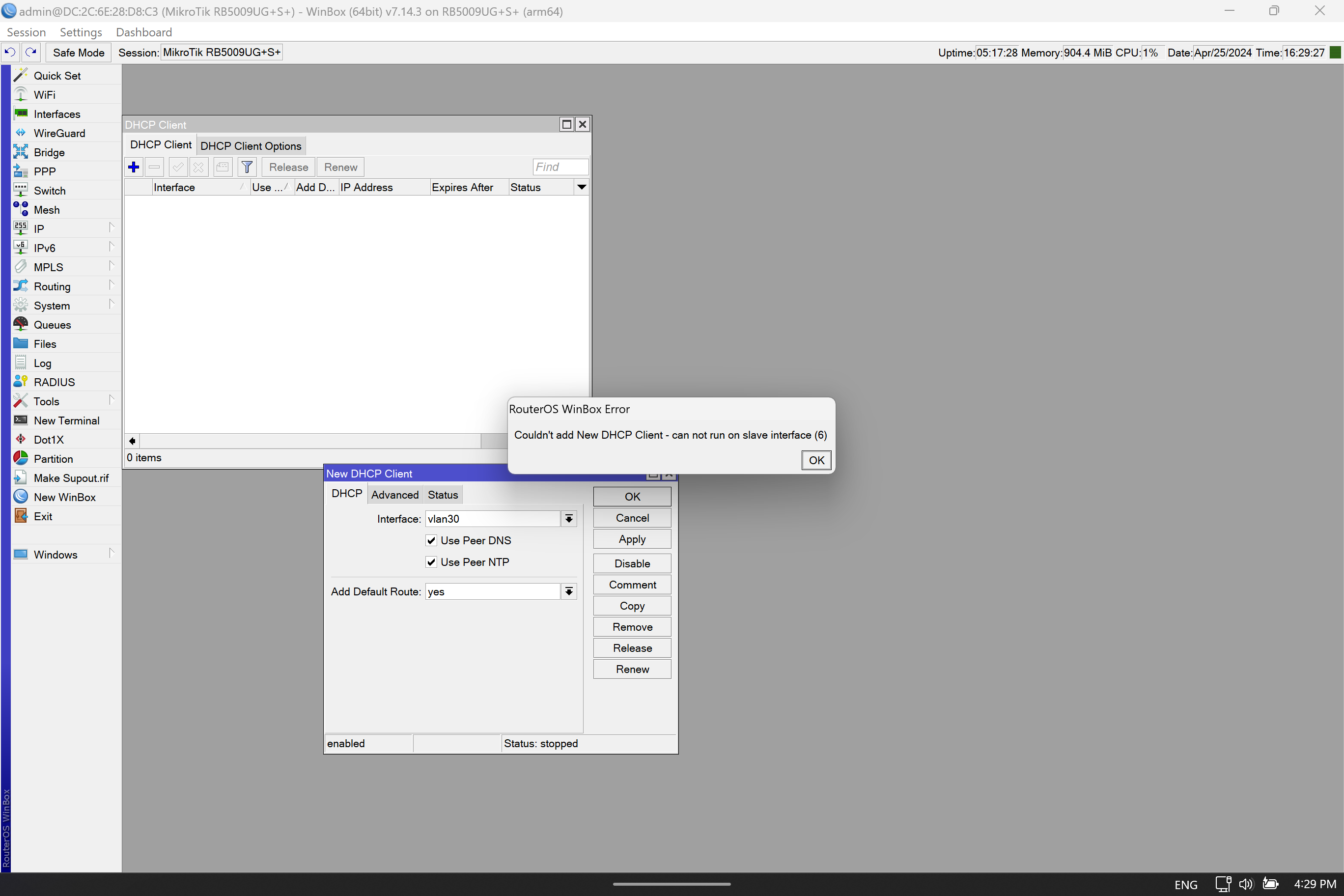

Wait a second, can’t you just add a VLAN30 interface, bridge it with the ether8 port and add a DHCP client if necessary? Why did I remain convinced that ether8 should be a trunk port? Now I feel as if I’d taken crazy pills
/interface vlan
add interface=sfp-WAN name=vlan30 vlan-id=30
/interface bridge add name=bridge_vlan30
add bridge=bridge_vlan30 interface=ether8-LAN8
add bridge=bridge_vlan30 interface=vlan30
/ip dhcp-client
add interface=vlan30
yes
i couldn’t add interface=vlan30
