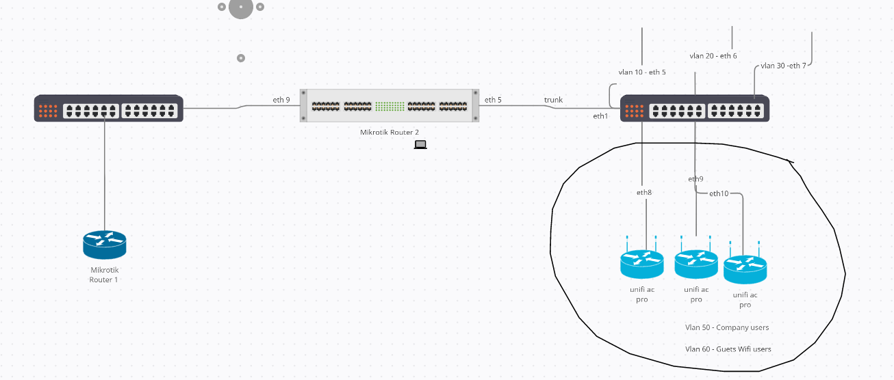

Hello guys,
I need your help about a problem that I have in my company network. I dont know if it is possible to achieve thats Im here asking your for suggestions.
I created for my company a couple of VLANs to segment my network. I created the vlans on the right switch on different ports as Access ports and I have eth1 from switch side as trunk port.
I created 2 other vlans for the wifi devices so I can use different networks for guests and users of the company. The switch(eth1) of the right side is connected with router (fiber connection) to a router(router eth 5 port).
So my question is, If I can somehow forward the vlan 50 and vlan 60 that are the wifi vlans to the other switch on the left side because I have there unifi controller.
Thank guys in advance.

The answer to your (pretty general) description is: yes, you can forward a few VLANs from left to right. To get some concrete advice you’ll have to post some concrete infornation, accompanied with existing configuration of mikrotik router 2 …

Hello MKX,
here are the configuration of the SWitch right side and the mikrotik Router 2
Router 2 configuration

Router is running ROS v 6.29 … which is ancient. Even though it seems to be in LAN core and thus doesn’t need firewall, I’d still install recent software (6.49.3) and configure it from scratch. The best way of doing it (from performance point of view) is not clear as we don’t know the router model (yet).
And the diagram from your initial post doesn’t correspond with configuration shown (diagram says WAN is ether9, configuration mentions ether2)
But if you want to keep running router at current SW version and assuming left side is connected to ether9, then you could do this:

But, as I wrote above, depending on router type and ROS version, there are at least two more configuration variants which might give much better performance and/or cleaner configuration.

Hello Mkx,
your solution didnt worked for me, but what I did was I connected 2 routers together directly and did a static route between them. So I managed to solve this problem like this.
